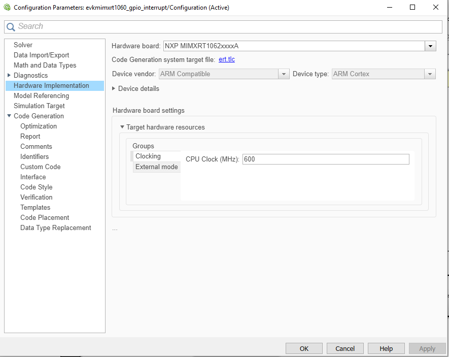

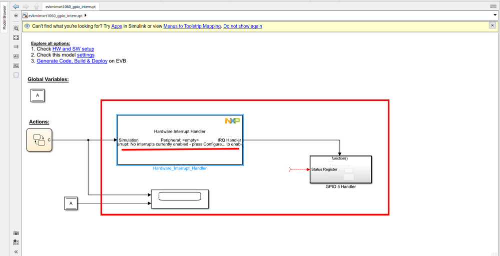

However, I notice some differences between what I have when I apply the tutorial steps and what I am  supposed to have.
On the one hand, here is the look of the example model in the NXP tutorial :
...here is mine :
Note the error message inside the "Hardware Interrupt Handler" block and the missing of the "Status Register" output...
On the second hand, here is the "Hardware Implementation" settings in the NXP tutorial :
... and here is mine :
Note the missing of several groups in the "Target hardware resources" section...

You need to go to Hardware Settings, under Hardware Implementation -> Target Settings-> Download -> Browse for OpenSDA drive:
BR,
Alexandra
5,666 Views
scocmr
Alexandra,
In Hardware Implementation settings, there is no "Download" group as it is shown on your screenshot.
Here are my settings :
As you can see, I have only 2 groups : Clocking & External mode...
Do I need to install a specific software to have "Download" group ?

You don't need to install extras - did you run again the mbd_imxrt_path.m after you did the update in matlab preferences with datetime format? That will recreate the NXP targets - I suspect that the initial run of that script did not created correctly the targets so you need to run it again.

Then, I have opened the NXP example model and set download settings as you mentioned :
I have launched "Build" and voila
The target has been correctly uploaded in the evaluation kit and the program works perfectly !!!
