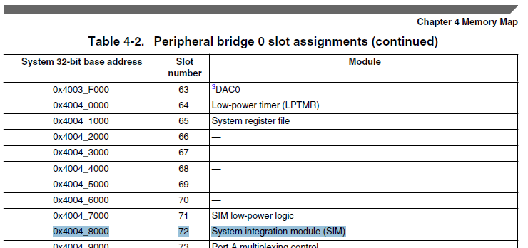

Hello, is there a Mac address assigned to the FRDM-K64F Freedom platform boards? I believe some skimming at mbed led me to believe there was. If so, is there any documentation on where and how to programmatically read and use it using MQX 4.1.1?

Sean, for deployment of a "real" product that really needs to have a unique MAC address, you can integrate a Microchip 24AA02E64 (or E48) -- it's very simple, but will cost you a little extra money and space on your PCB.
Here's how mbed does it -- they query a memory region in the K64 that is marked "System integration module (SIM)".  I don't know what this module does, but I'm going to look it up shortly.  Anyhow, here's their code for getting a "semi-unique" MAC address.  I think this is the approach I will be using in my device since it's not IoT or anything like that.
void mbed_mac_address(char *mac)
  // Fetch word 0
  uint32_t word0 = *(uint32_t *)0x40048060;
  // Fetch word 1
  // we only want bottom 16 bits of word1 (MAC bits 32-47)
  // and bit 1 forced to 1, bit 0 forced to 0
  // Locally administered MAC, reduced conflicts
  // http://en.wikipedia.org/wiki/MAC_address
  uint32_t word1 = *(uint32_t *)0x4004805C;
  word1 |= 0x00000002;
  word1 &= 0x0000FFFE;
  mac[0] = (word1 & 0x000000ff);
  mac[1] = (word1 & 0x0000ff00) >> 8;
  mac[2] = (word0 & 0xff000000) >> 24;
  mac[3] = (word0 & 0x00ff0000) >> 16;
  mac[4] = (word0 & 0x0000ff00) >> 8;
  mac[5] = (word0 & 0x000000ff);
Hope this helps.

Rick_Li
the MAC address is defined in frdmk64f.h which is located in {MQX}\mqx\source\bsp\frdmk64f\.
the MAC address is defined as {0x00,0x00,0x5E, 0, 0, 0} as the base address and then you can change the MAC address in file init_enet.c by re-define value of parameter "value".
I hope it helps!

ironsean
Contributor V
Dave, thank you very much!
Based on this manual: http://cache.freescale.com/files/microcontrollers/doc/ref_manual/SIMRM.pdf
"The SIM supplies a clock signal to the rest of the microcontroller, provides system protection features, and manages the external bus. In addition, the SIM provides on-chip chip-select signals and (if the pins are not being used for their alternate functions) I/O ports."
And based on the information there it looks like the SIM contains some unique identification registers which mbed is using as a basis for generating a MAC Address, which they set to Locally Administered to prevent it conflicting with proper assigned MAC addresses in the field.
That's very interesting to know that's there, and how mbed determines it's MAC address. This also answers my question about whether it is valid or not. For development this would be fine, but we actually are developing IoT devices for the field so an external chip with a MAC will be necessary.
Sean

Rick_Li
Hi Sean Mackay,
there is NO included/assigned offical MAC address on the boards, you have to buy MAC address from OUI for your product.
The MAC address {0x00, 0x00, 0x5E, 0, 0, 0} can be used for development!
