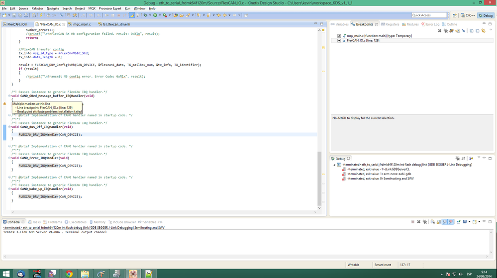

Hello at present, I'm trying to work with the new develoment tool "Kinetis Design Studio". I want to develop an aplication with MQX in the FRDM-K64F.
I've tried to create a project MQX in KDS for differents ways:
*Create a project in Codewarrior 10.6 and import to KDS.(not compile)
*Create a project in KDS with/without Process Expert and KSDK.
*Create a simple project with Process Expert and KSDK, and include the component MQX and MQX task in my project.
Of the last two forms, I get to compile without errors, but i can't debug. Show the error "Can not read register XX (XX) while CPU is running".
How can i work with KDS and MQX? How can i create a MQX project?

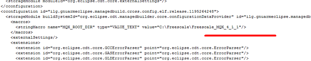

  3. Open for editing the .cproject with any text editor
  4. Search in file for "MQX_ROOT_DIR"  and change the value like this : "MQX_ROOT_DIR" type="VALUE_TEXT" value="C:\Freescale\Freescale_MQX_4_1"/>
  5. Replace the string '${ProjDirPath}/../../../../../..' by ‘{MQX_ROOT_DIR}'  (All the matches)
  6. Save the changes
  7. Import the project into KDS and build. You should build without errors.
  8. Change the project name if you want and now you have a MQX Template project that you can copy&paste any times and add the new sources.

BlackNight
Could it be that the code for FLEXCAN_DRV_IRQHandler is not linked?
That would explain why the breakpoint settings fail.
Can you check in the linker .map file that this function indeed is linked?
Erich

LuisCasado
Hi Kevin,
I can debug your code
There are multiple issues (Watch and read the Warnings, they are also important). Basically you have many implicit function calls, aka, it has not been resolved by linker. You need prototypes of functions in header files, for example:
void IniciarCAN(void);
And I have commented out all the ‘printf' as they are also implicit calls.
But the more important issue is that you have a function static void init_hardware(void) that is also included in the MQX BSP. I have not investigated why GCC linker doesn't complain, but removing the function, it works.
Luis

kevincarcel
Hi Luis
I also could debug and add breakpoints in the function IniciarCan(), but I don't add a breakpoint in the interrupt or interrup handler.
void CAN0_ORed_Message_buffer_IRQHandler (void)
o
void FLEXCAN_DRV_IRQHandler (uint8_t ejemplo);
I've added your changes, but I can not.
Thank you very much Luis.
10,039 Views
LuisCasado
I think that code isn't linked in the application. You're not installing the CAN interrupts in the MQX application.
Luis

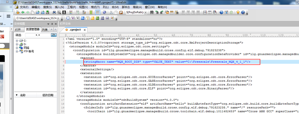

your path is "C:\Freescale\Freescale_MQX_4_1_1" not "C:\Freescale\Freescale_MQX_4_1", so change MQX_ROOT_DIR accordinly.
Luis
10,087 Views
Hi Luis
Yes , my path is MQX_4_1_1,  and so  in the .cproject  file i already  write accordingly like the screenshot below .
And  the attachment is the .cproject file.
Thank you !

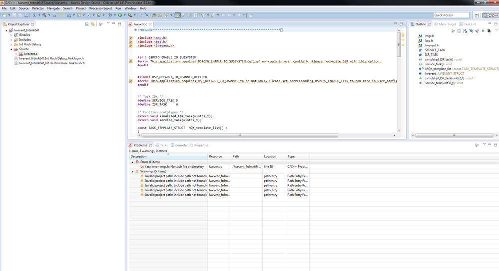

Hi luis,
I  put your project on the desktop, and build it use kds 1.1.1 ,while it still have error , i need your help .
Thank you !
Alice
