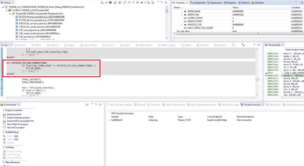

Hi, I've spotted a strange problem with the MQX4.1 web server. After a few hours of working it becomes unresponsive and I can't log into.
It's very random behavior and sometimes server dies after few days, sometimes more frequent.
Restarting the HTTPSRV by using HTTSRV_release() and HTTPSRV_init() is not solving the problem.
I've noticed that every incoming TCP packet has been dropped because the CONN_COUNT>=RTCSCFG_TCP_MAX_CONNECTIONS.
Because of the memory usage the  RTCSCFG_TCP_MAX_CONNECTIONS = 2 in my case.
I don't understand why the CONN_COUNT =2. It looks like the RTCS is not releasing the connections properly.
After some tests I can say that the crash happens whenever two clients trying to connect to the server at the same time.

Unfortunately it is hard to say what could be reason for that behavior. Since using HTTSRV_release() and HTTPSRV_init() is not solving the problem, problem will be probably somewhere deeper and limited number of TCP connections is probably just side effect.
Because it's very random behavior it could happened that we lost some connection end packet…
It is also possible that this source of this issue was already fixed.
As first I would like to recommend test it on MQX 4.1.1.
Latest released RTCS could be used from MQX4.1.2 for Vybrid or from KSDK1.1.0.
https://freescale.flexnetoperations.com/control/frse/download?element=6003621
https://freescale.flexnetoperations.com/control/frse/download?element=6011601
Could you please test it with some newer RTCS code?
BTW: There is also MQX 4.1.0.1 patch which contains several important RTCS bug fixes. Did you install it?

Thanks Radek,
Your solution works! I have tested the MQX 4.1.1 + RTCS 4.1.2 for Vybrid and the web server is rock solid now. This is the http server I've been waiting for a long time (since MQX3.6) :smileyhappy:. Good job.
Unfortunately, the size of the new RTCS 4.1.2 is bigger than 4.1.1 and I can't use it because my code exceeds the internal memory size for my micro now .
Is there any way to shrink the new RTCS  by removing some components i.e.  websockets?
