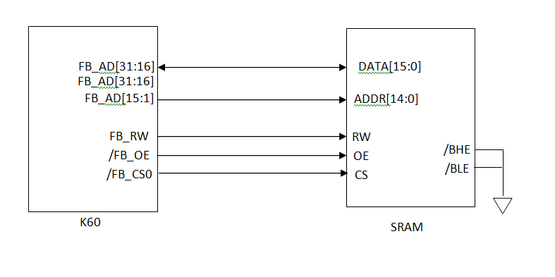

Hello Freescale,
I try to run the sample code explained in AN4393 (section 3.1.2)
on TWR-K60F120M and TWR-MEM. In my code I write and read
an 8-bit value in the first 16 location of MRAM. The interesting is
that once I disconnect the twr-mem from the cpu, it still write and
read the right value. To me that means the value is written in
internal ram not external! I attach my MQX 4.0.2 project created
by CW 10.5 to this email.
I wonder if I need to change something in BSP or user config to
enable the external memory?!
Cheers
Original Attachment has been moved to: flexbus.rar
1,597 Views
Martin_
Note the AN4393 uses 0x60000000 as base address for Flexbus. On K60F120M it is cacheable memory region. After you disconnect TWR-MEM you should invalidate the cache line to force the MCU to access physical memory.  MQX provides: void _dcache_invalidate_line(void *addr) function for this.
It is also possible to use 0xA0000000 for Flexbus non-cacheable access.

Hello Martin,
Thank you for your reply. That was very helpul. I used 0xA0000000 as the base address and that works well on the TWR-MEM.
So, I try to implement the same concept on a customized board with a 16bit SRAM. The figure below shows our hardware schematic.
The memory is word-addressable (16-bit), so the FlexBus word address line FB_AD[1] is connected to A[0] of the memory.
Thus, FB_A[15:1] are connected to A[14:0] of the memory.
I initialize the flex bus in 16bit mode using the following code:

FB_CSAR0 = (unsigned int)&MRAM_START_ADDRESS_8; //Set Base address
FB_CSCR0 = FB_CSCR_PS(2) // 16-bit port
| FB_CSCR_AA_MASK // auto-acknowledge
| FB_CSCR_WS(0x2) // 2 wait states
FB_CSMR0 = FB_CSMR_BAM(0x7) //Set base address mask for 512K address space
| FB_CSMR_V_MASK //Enable cs valid signal
I try to write and read a 16bit value to the SRAM over flexbus by using the following code:
int wdata16 = 1;
unsigned short *p_16;
p_16 = (unsigned short*) FLEX_BASE_ADDRESS;
for(n=0x00010;n<0x001F;n++) //address offset
    *(p_16 + n) = wdata16;
     rdata16 = *(p_16 + n);
     wdata16<<=1;
the problem is that rdata value is different from wdata! I'm not sure if I missed something in hardware or firmware side!
any comment on this issue kindly appreciated.
