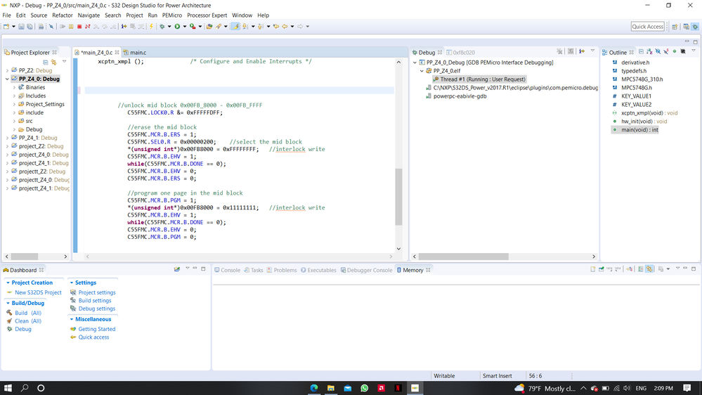

ok im using the example code (
If you don’t use SDK, here’s an example which does not use drivers:
https://community.nxp.com/t5/MPC5xxx-Knowledge-Base/Example-MPC5748G-Flash-RW/ta-p/1123178
i have written the following code:
//unlock mid block 0x00FB_8000 - 0x00FB_FFFF
C55FMC.LOCK0.R &= 0xFFFFFDFF;
//erase the mid block
C55FMC.MCR.B.ERS = 1;
C55FMC.SEL0.R = 0x00000200; //select the mid block
*(unsigned int*)0x00FB8000 = 0xFFFFFFFF; //interlock write
C55FMC.MCR.B.EHV = 1;
while(C55FMC.MCR.B.DONE == 0);
C55FMC.MCR.B.EHV = 0;
C55FMC.MCR.B.ERS = 0;
//program one page in the mid block
C55FMC.MCR.B.PGM = 1;
*(unsigned int*)0x00FB8000 = 0x11111111; //interlock write
C55FMC.MCR.B.PGM = 0;
i have nothing changed in the memory as follows
2,528 Views
lukaszadrapa
This code works as expected, I tested it.
Make sure that the data cache is either disabled or that it is invalidated after these flash operations.
Lukas
