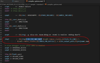

The AUTOSAR_OS file compiled in the S32DS project is about to be generated
There's an error
dld.exe: error: -Xstop-on-redeclaration is on. Linking aborted111.png111.png

Ah, sorry, I haven't checked thoroughly. Looks like VTABLE and _start are redefined in your project. Cause these objects are already defined in OS code, you need to remove the code created by S32DS (./src/vector.c and ./Project_Setting/Startup_Codes/startup.c)

I'm sorry. I looked at it again. It's a double definition

This option should not be appeared in the Linker options list. See the linking option in compiler_options.mak file, which is marked with ldopt keyword:
So you need to modify the linking option list in your S32DS project in order to match with the list in the sample application.

Thank you for your reply. After reading the makefile for a long time, I am a little confused.
Could you please give me more details about how to match it in S32DS
