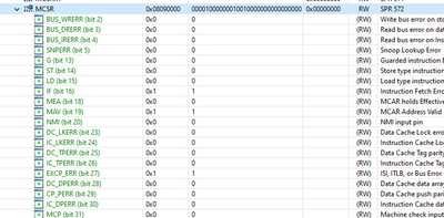

The erase looks ok, but when I program the flash I get exception IVOR1
Code is below
ret = FLASH_DRV_Program(&pCtxData,0x00840000,size,from);
Exception as below, with Instruction fetch error bit set in the MCSR register.

IVOR14 means that you are jumping to area which is not covered by MMU. My recommendation is to step the "start();" command in asm instructions and check the core registers to see where it jumps exactly (if it is expected address).
Because it obviously jumps to some wrong address, application is not executed at all, so IVPR is not updated by the application and this exception takes vector from the bootloader.

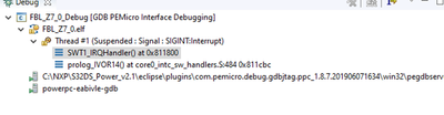

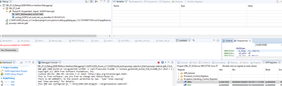

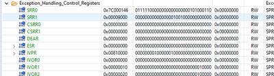

Now I am able to program and confirmed it by checking the CRC32 but executing the application is failing with IVOR14 and it is pointing to the exception table from boot  as shown below
start = (void (*)(void))(*(uint32_t *)(0x00840000+ 0x400));
start();
1) Could you please let me know why I getting exception IVOR14 wuth SRR0 pointing to a weird address?
2) Why is the exception table from boot invoked when I am excecuting the App?

Below is the correct address to execute the App and now its ok.
start = (void (*)(void))(*(uint32_t *)(0x00840000+ 0x4));
start();
