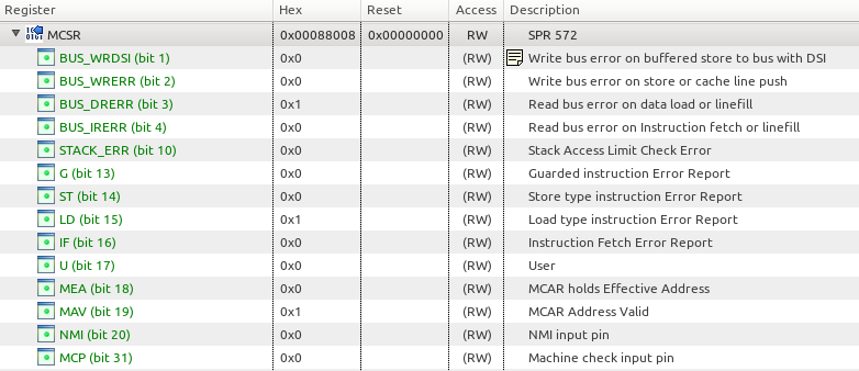

The content of the MCSR register:
The C55FMC.MCR register:
Does this mean that the IVOR1 exception was not caused by reading from the flash? (When I've had IVOR1 problems with flash reads, then bits in the C55FMC.MCR register has been set).

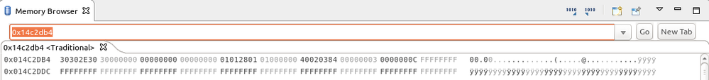

The content of the 24 bytes .sdata section in flash.

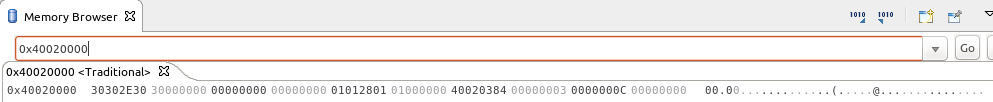

The content in ram for [_data, _edata):
Any suggestions on how to proceed? How can I figure out if this is a problem in RAM or FLASH? I'm working on reducing this down to a program that I can post here for more feedback.
