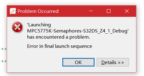

there was a strange problem that I couldn't download the code sample.  What should I do now?
Thanks.
in S32DS becomes some GDB problem sometimes (this can be caused many reasons) and it is necessary to "kill" processes, which care about GDB functionality. Please look at the following thread, stanish describes there how to solve this issue.
Eternal "configuring GDB" if P&E Multilink not connected or target OFF
Martin

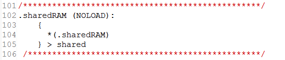

How do I understand the part in the section.ld file. Is there some reference about IDE LINK file?
Ron
Hi Ron,
please look at the gcc linker documentation.
https://www.google.com/url?sa=t&rct=j&q=&esrc=s&source=web&cd=1&cad=rja&uact=8&ved=0ahUKEwid3P-J96TN...
or https://www.google.com/url?sa=t&rct=j&q=&esrc=s&source=web&cd=2&ved=0ahUKEwid3P-J96TNAhULCcAKHSyZCUw...
About the section you shared:
NOLOAD: The section should be marked as not loadable, so that it will not be loaded into memory when the program is run.
All what is add to section .sharedRAM will be placed to shared. Symbol shared is defined in mem.ld ( shared :    org = 0x40000000,     len = 4k )
