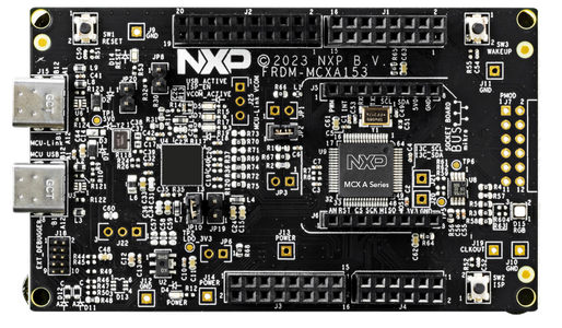

FRDM-MCXA153

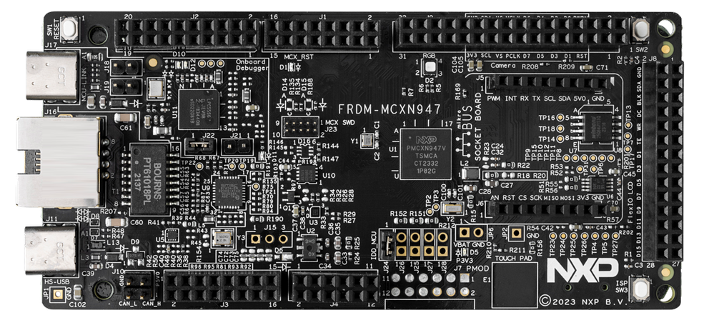

FRDM-MCXN947

About the hardware.

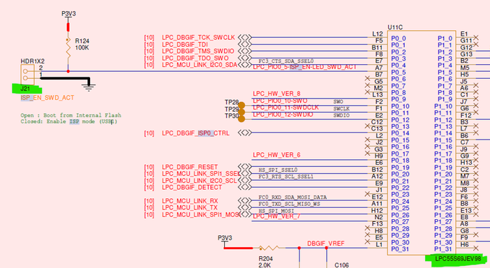

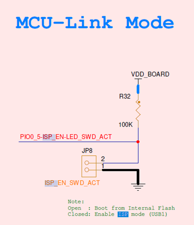

You may need the EVK connected to the computer under DFU mode, in the schematic of the EVK does not mention the DFU but has the named jumper of ISP [JP21] MCX - N or [JP8] MCX - A, sure you put the LPC55s69 in ISP, not the MCX, review the schematic below.
MCX - N
MCX - A

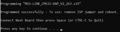

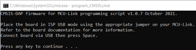

Then open the CMD prompt console and run the script for CMSIS.
The console asks if you have the appropriate jumper, if yes click enter again.
If everything is right the message successfully will appear.
