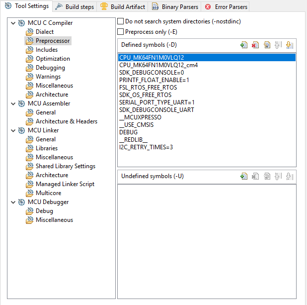

I noticed that a missing or bad I2C device causes MCU reset by watchdog. This is because of the infinite loop (Bold section in the code below) used in I2C driver functions such as:
1. I2C_MasterTransferNonBlocking() + I2C_MasterTransferAbort()
2. I2C_MasterTransferBlocking()
In the driver, if "I2C_RETRY_TIMES" defined, then it could get out the loop, see the code below.

I do not want to add the definition in either fsl_i2c.h or fsl_common.h file, I am wondering if there is a driver configuration file, like FreeRTOSConfig.h for FreeRTOS for user to pass the configure information, or what is the best way to do so.

One way to do it as my colleague Kevin pointed out is to define that in Preprocessor, "I2C_RETRY_TIMES=3". It does work but place it into a file will be better.

Yes. put the macros in Preprocessor is the right way.
