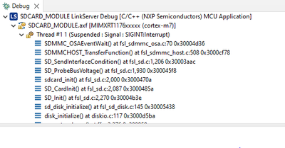

I am also facing the same issue. (RT 1170 custom board)
SDK version: 2.14
How can I resolve this?
"Timeout can be configured to avoid the hang on that part."
How do I configure the timeout?
Which type of card are you trying to interface?
SDHC (32 GB)

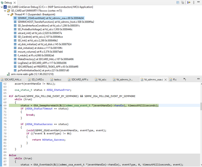

Similar issue -Infinite wait when initialising SD card with FatFS and FreeRTOS on RT1176
"Does the SDK unmodified example work correctly? It can be helpful to restart the host before initializing the Sdcard."
Same issue for example projects "evkmimxrt1170_sdcard_fatfs_cm7" and "evkmimxrt1170_sdcard_fatfs_freertos_cm7"

I tried using the example code(evkmimxrt1170_sdcard_fatfs_cm7), but it gets stuck in SDMMC_OSAEventwait()

As I mentioned, you must check all of the conditions needed by the SDcard software.
From the stack trace you included, while the code waits in SDMMC_OSAEventWait, it is waiting due to the transfer that was initiated from SDMMCHOST_TransferFunction, which was called from SD_SendInterfaceCondition, which was called from SD_ProbeBusVoltage....
SD_ProbeBusVoltage is called from sdcard_init...     If BOARD_SDMMC_SD_IO_VOLTAGE_CONTROL_TYPE is set to kSD_IOVoltageCtrlNotSupport , this code should be skipped over.
Even though your card socket doesn't have a card detect pin, the code checks for the status of the pin assigned in sdmmc_config.h      Make sure you have set these up appropriately...

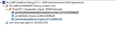

Now, I'm facing an issue while creating a new project. The SDK example works fine, and modified SDK examples also work fine. However, in the new project, when I call the function f_mkdir it gets stuck in a loop, as shown in the attached image.
After this,
Am I missing any settings? How can I resolve this?
