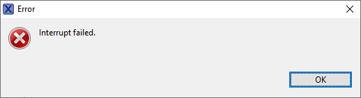

I'm currently having a situation with my RT1050 where I'm trying to breakpoint inside a particular FreeRTOS task, but when the breakpoint is reached, the debugger fails to suspend itself and instead throws up a dialog stating "Interrupt failed" when I try to manually suspend the debugger afterward.

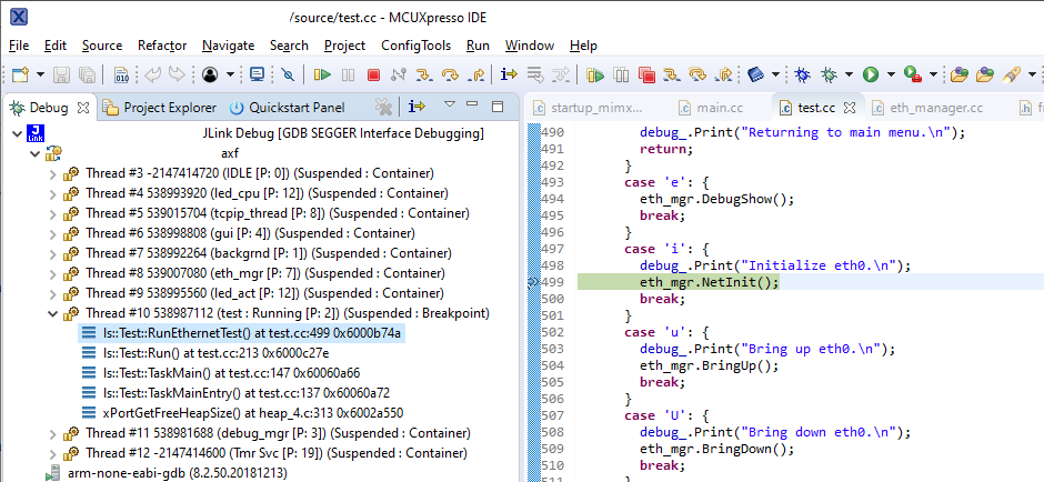

So my application boots normally.  If I manually pause the program, I get a valid debugger context:

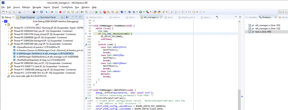

This happens to be the task I want to step into, so I've got a breakpoint set at the switch() statement just after the message queue receive call returns.  I also have a second breakpoint set inside the method NetIfInit() just below there; I would expect the debugger to hit both of those, or at least one.
I've also set a breakpoint inside my test function that will initiate the message queue send.  When I press my keys on the serial console, the debugger hits that breakpoint and halts.

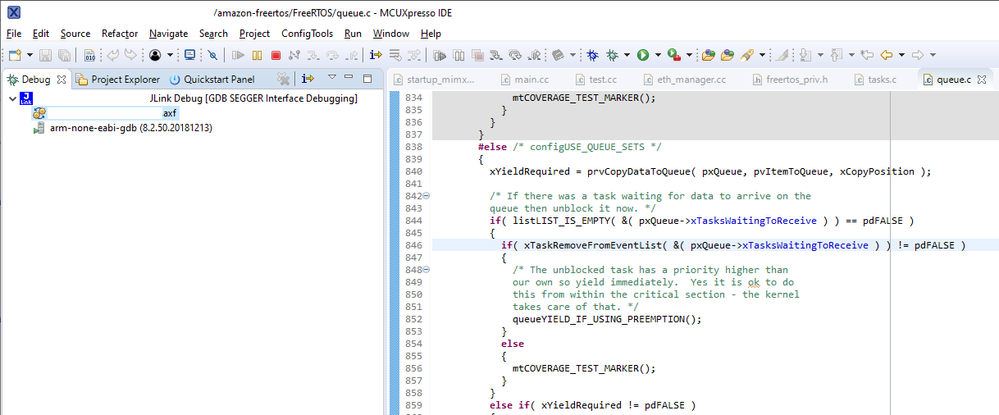

Then I step into that NetInit() function, which eventually calls xQueueSend(), which after a pregnant pause the debugger steps into.  I then step through the body of xQueueGenericSend() until I get to this point right here:
Once I try stepping over line 846, the debugger pauses for some time, then loses context.  Note that I've lost my Resume All / Suspend All / Terminate All buttons, and also my thread list at the left.  The only available buttons are Suspend and Terminate for this session.  If I click Suspend (pause), the IDE sits for a few seconds, then throws up this dialog:
And that's it, game over for the debugger.  Meanwhile, my serial console is stalled with some half-written UART output.  One might think that oh crap, I've gone and blown my stack or something, target must be dead... nope.  The only button remaining is the red Terminate (stop) button, and if I click that, the debug session terminates, and execution resumes... my tasks are good and alive.

So it seems that execution did in fact stop at the breakpoint I set, it's just that the debugger crapped itself.
Any idea why the debugger would lose its mind like this?
