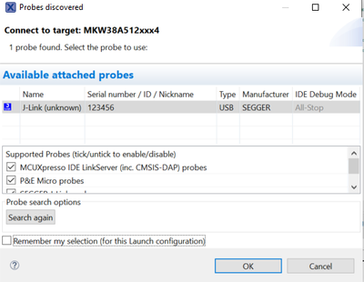

I tried to debug the example of the frdmkw38_adv_ext_central_freertos on the freedom development board of KW38, but there was something wrong.
Precondition:  freedom development board + USB OpenSDA
ps. the frdmkw38_beacon_freertos and frdmkw38_hs_beacon_freertos were OK
the information of the console is below:

Hi @Colinn ,
Thanks for contacting NXP support.
There were some occasional problems while debugging with CMSIS-DAP, and I tried it on my side, using J-Link, which is able to flash and debug.
Could you try it? Only simple modifications are required. Here is a very detailed step you can refer to.
https://community.nxp.com/t5/Wireless-Connectivity/Error-occurs-when-debugging-FRDM-KW36-Unable-to-c...
And I attached a screenshot from my side. Hope you are doing well!

Colinn
Hi Gavin,
Thanks for your advise, it is very useful !
I burn the J-LInk Bin into the board , and I can debug the example via the J-Link now.
B.R.
