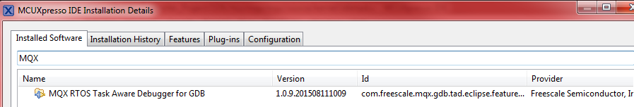

We have ported a project from KDS, using KSDK 1.2.0 and MQX for KSDK.
We would like to continue to use the MQX TAD inside of MCUXpresso (Currently using MCUXpresso 10.0.2).
I have the MQX RTOS TAD installed inside MCUXpresso:
But when I pause debugging nothing is displayed in the MQX windows:

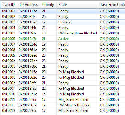

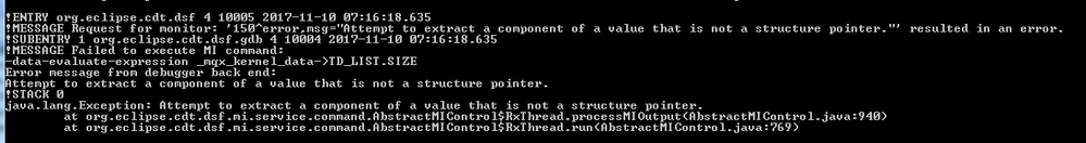

I just wanted to provide an update to the community in case anyone else is running into this issue. It turns out that MQX TAD DOES work in MCUXpresso IDE! The reason it was not working for me before was because I included the release version of the MQX library, instead of the debug version.
I realized this after enabling the eclipse console and viewing the output when I paused the debugger and tried to load MQX TAD views. There were lots of errors in the log. Here is an example:
I then tried to put the _mqx_kernel_data->TD_LIST.SIZE into the expressions view in the debugger, and it gave the same error.
I then rebuilt my project using the debug version of the library without any optimizations, and the MQX TAD works as expected!
