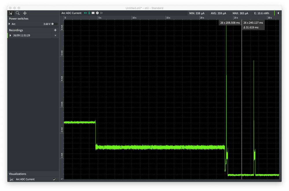

Hi Alice, now I have made some more small changes to the example of 'lpcxpresso55s69_power_manager_lpc' to allow enter deep-power-down with no debugger keyboard input, now it can enter deep-power-down with no debugger connected.
The current will now drop to ~365uA in deep-power-down. But this is higher than ~15uA for power-down, and still much higher than data sheet value of ~790nA.
See attached screenshot, and here is my sequence of events...
So with code modified for no keyboard GETCHAR() input, this happen...
1. Time at start of trace (before ~4.8sec) is to load code into debugger - stop at main().
2. At the ~4.8sec point, I start execution. Code will go straight to code of 'case kPmu_Deep_PowerDown:' and set RTC alarm for 4sec. Current is ~1.4mA
3. No wakeup will occur! As I said before, "With debugger attached I found MPU it can't come out of deep-power-down state".
5. At ~23.5sec I hit reset button. Now code will execute with no debugger attached. From that point code will quickly enter deep-power-down and the wake up by RTC at 4 sec alarm. It then restart and the cycle will repeat.
6. So now I am confident that MPU will get to deep-power-down-state but the trace shows current is ~359uA (at the marker of "26 s 208.508 ms").
Two questions for you:
1. What do I need to do for MPU enter deep-power-down state when debugger is connected?
2. How to get current from ~359uA down to data sheet value of ~790uA?
A copy of my modified file of power_manager_lpc.c is attached
Please check.
WARNING: After run this code take care to fit EVK jumper J10 to force ISP mode because debugger can't load new code when MPU in deep-power-down state!
Jon

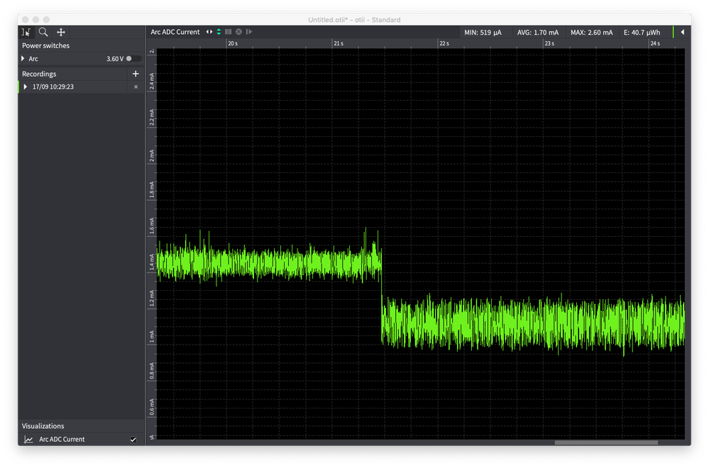

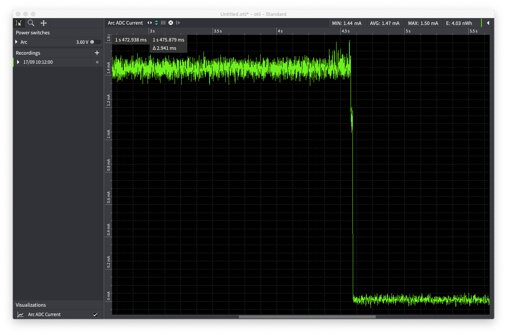

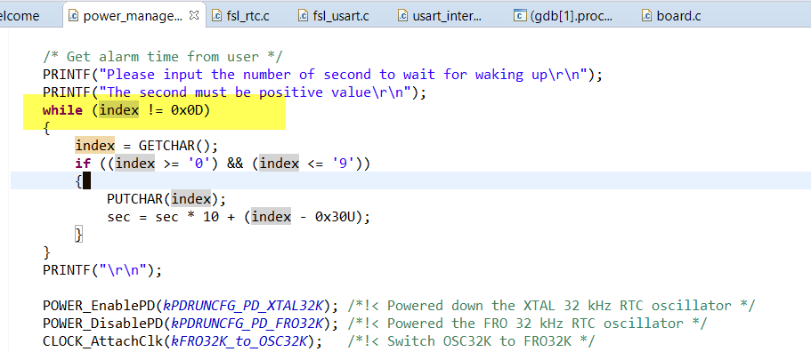

Hi Alice, Thank you for you reply. Here is more info about this issue.
Firstly, I use MCUxpresso SDK example of 'lpcxpresso55s69_power_manager_lpc'.
For this I need to make one small change because on MAC OS I get '\n' character (instead of 0x0D) as line-ending for semi-host GETCHAR() input. My change for this is in file power_manager_lpc.c at line 117:-
NXP original code: while (index != 0x0D)
My change: while (index != '\n' /*0x0D*/)
This change will have no effect on current measurements.
I measure MPU current using NXP LPC55S69-EVK. (See NXP doc UM11158.pdf see section 5.1) This has 2.43ohm resistor (R91) connected to P12 for current sensing.
My measurements and screenshots come from Otii product configured to measure current by reading voltage across the 2.43ohm resistor. See here for info about Otii: https://www.qoitech.com/products/standard
The 'lpcxpresso55s69_power_manager_lpc' example will offer a menu to choose an option for reduced power mode. Normal running current appears to be ~1.4mA.
If I choose option "3. power down mode" it will work well. I get a current ~15uA and MPU will wakeup ok. See my screenshot "Otii screenshot lpcxpresso55s69_power_manager_lpc (option 3)power-down mode.png".
If I choose option "4. Deep power down mode" (followed by number of seconds for wakeup) the current will drop to ~1.1mA (data sheet offers 790nA) and MPU won't wake up after RTC wakeup period has passed. See my screenshot "Otii screenshot lpcxpresso55s69_power_manager_lpc (option 4)deep-power-down mode.png".
It's my guess that deep-power-down will enter hard-fault handler, but can't say for sure due to the reasons I mention in my original posting.
Any questions then please ask.
Jon

Hello Jon Green,
Sorry I just find in the code, when we choose 4 Deep power down mode, after input the second
to wait, we need send 0x0D (HEX), or it won't enter Deep power down mode:
I test on my side again, it can wake up after some seconds.
Could you please test it and measure the current. Also take a screenshot about the result on your Terminal .
