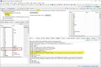

I relocated the vector table in an MCUXpresso v11.6 FreeRTOS project to 0x8000 (via the MCU Settings) so that I can add a bootloader later.  However, I am now unable to debug this project--it complains that it can't find source code at 0xfffffffe and then crashes, even after I set the Program Counter to the function "ResetISR" in the Debug Configuration [PEMicro's "Set PC (absolute hex address or symbol)"].  I also tried setting it to ResetISR's location: "0x815D" and "815D".
I have successfully done this in CodeWarrior v10, years ago, but I even tried an MCUXpresso UART SDK example project and had the same results.  Can someone try an SDK example on their machine, with the MCU Settings' PROGRAM_FLASH set to 0x8000, length = 0xF0000?  Or am I missing something?

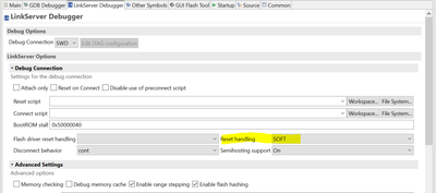

From a high level perspective, I think you'll need to make sure that "soft reset" is used once the app is programmed in flash at the given address, forcing the debug stub/server to use the entry point found in the app. This is somehow similar to a RAM debug session. So don't leave the bootrom the opportunity to set the entry point after system reset but allow the debugger to set the entry point (read from the app) after flash is being performed and soft reset is issued.

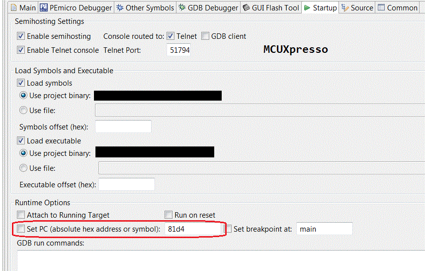

Back then, I successfully debugged an application with a relocated vector table in CodeWarrior v10 without a bootloader or extra symbol loading. It seems this grayed-out setting is involved:
I assume the debugger gets the "Program entry point" from the ENTRY() setting in the linker descriptor file (*.ld) and then sets the Program Counter.  I suspect this same feature in MCUXpresso v11 (which I have to manually type in myself) doesn't work:

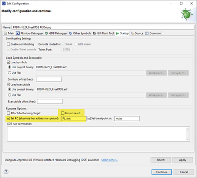

- then what happens depends on how you have configured the launch configuration: usually gdb will set a breakpoint on main symbol, the performs a reset with the probe and the target does whatever it has to do on reset (means fetching the initial PC and SP from the vector table)
Now if you want to set the initial PC 'manually', then you have to disable the 'reset' part.

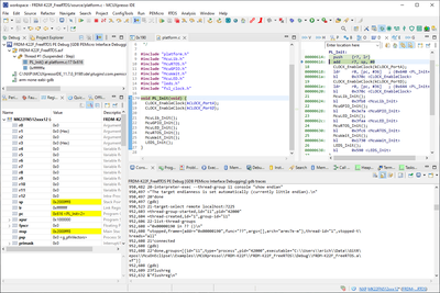

I see from your screenshot that you are using a PEMICRO probe, so I just verified that on my side, using the IDE 11.7.0: Disabled the 'run on reset' and set the initial PC to the PL_Init function/symbol:
Now if I launch it, I get this:
That looks not exactly what I would expect. The source file is shown for 0x190. This looks like something in the GDB (see gdb traces) where gdb tries to get a list of threads (which do not exist at this stage), so possibly a glitch.
But as you can see in the Registers view, the PC is correctly configured and set.
And indeed, if I do an assembly step, it shows me that the PC was set where I wanted to have it:
