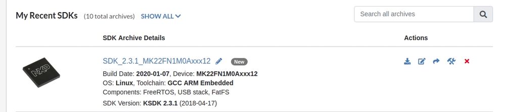

Hiya,
I've spent a number of frustrating hours trying to create an SDK that will work with the Linux version of MCUXpresso.
I'm using the online tool, selecting "Linux" as the target and "GCC ARM Embedded" as the Toolchain.
Here is a screen shot of the build information from the SDK dashboard:
I am downloading the SDK, un gunzipping it, un tarring it and trying to drag the folder or a .zip file into the "Install SDKs" view at which point I get asked if I'm sure I want to import it followed by a message saying it was unable to load the SDK.  When I look at the MCUXpressoIDE's error log (regardless of whether I am trying to load the folder, .zip or even the .tar.gz), I get:

The following items are not supported or not valid SDKs
[/home/myke/LinuxSDK/SDK_2.3.1_MK22FN1M0Axxx12.tar.gz]
I have no idea why that line is at the bottom as, as noted,  I have ungunzip'd and untar'd the file I downloaded so this is in one of the various files.  I have attached the file that was downloaded from the SDK site.  I am running Ubuntu 18.04.03 LTS
I should also point out that this happens if I use something like a Freedom board SDK.
I'm having no trouble with Windows (but want to transfer my software development from Windows 7 to Linux).
I'm sure I'm doing something simple wrong but I've got no idea what it is - any help is appreciated!

To use an SDK with MCUXpresso IDE, you need to build then install one that has MCUXpresso IDE support configured as the toolchain - NOT vanilla GCC ARM Embedded.
If you install the current MCUXpresso IDE v11.1.0 release, then you can do this directly from within the IDE - with having to use the website SDK builder at all. For more details, please see the MCUXpresso IDE v11.1.0 documentation, along with the release information at:

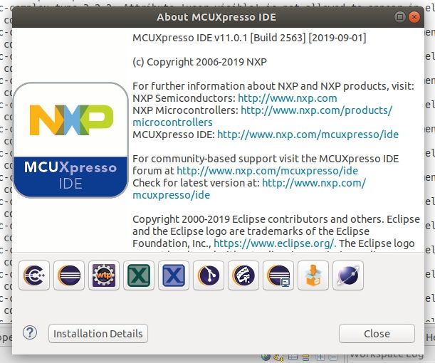

No, one minor point of confusion all the documentation says that the latest version of MCUXpressoIDE is v11.1.0 - but when I look at "About" for MCUXpressoIDE for Linux 0 it says that it's version v11.0.1 as you can see from this screen shot:
What is the correct version number for the Linux version of MCUXpressoIDE?  When I click on "Check for Updates" is says "No updates found".

The latest version of MCUXpresso is 11.1.0 for all platforms. NXP does not support upgrading from one release to another, so you need to download and install 11.1.0

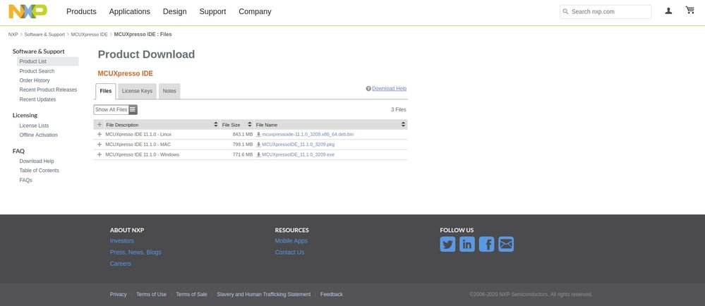

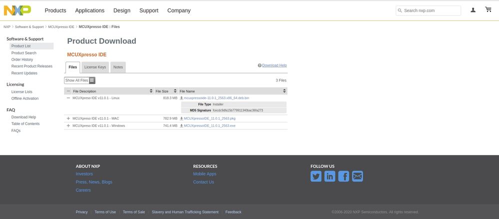

First off, I downloaded MCUXpressoIDE on January 7th of this year.  I hadn't deleted the tab yet and here it is:
When I saw your email, I went to the NXP MCUXpressoIDE download page today and discovered that the version was now different:
Any ideas what's happening here?  The Linux PC was booted on January 7th and maybe it picked up an cached page but I have no idea how that happened - I've been on a Windows PC primarily (which does have v11.1.0) and started moving to the Linux system.  I had not loaded in any previous versions on to this system.
