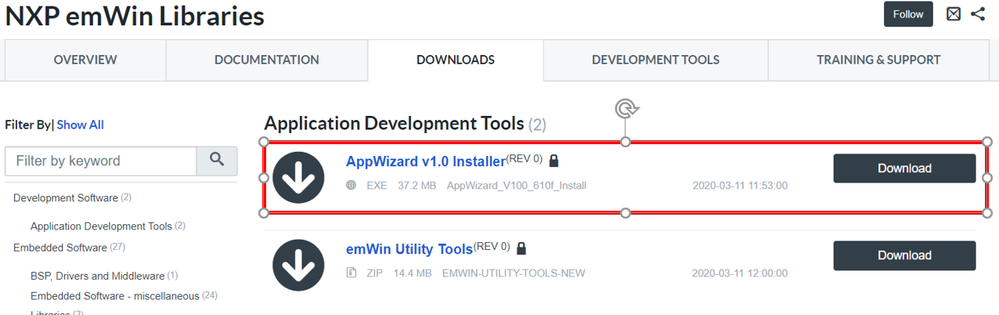

AppWizard can be downloaded from the NXP emWin Libraries Download tab. Navigate to www.nxp.com/emwin-graphics-libraries, click on the download tab, and then click on Download next to the AppWizard Application Development Tool.   pastedImage_1.png
Clicking this link will download an installer to your PC. Just run the installer and follow the prompts to install AppWizard to your PC. Remember that NXP recommends selecting defaults for any install options present.

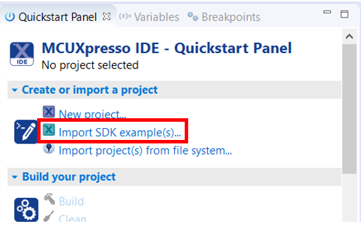

  1. Open MCUXpresso IDE and select any workspace desired.

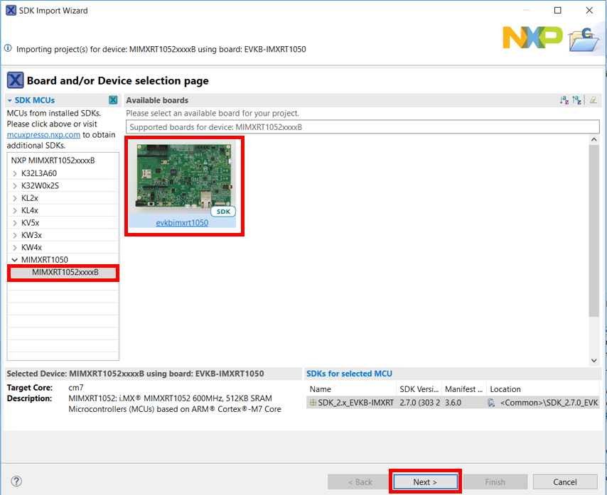

  3. Select your Board or Device. Make sure your board or device is supported by emWin in the SDK. For this example, we will select the evkbmimxrt1050. pastedImage_3.png

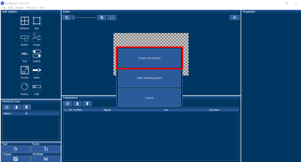

  1. First open AppWizard.  If this is the first time you have opened AppWizard, it will prompt you to create a new project, open a project, or cancel (which would simply close the application).  If so, select "Create new project".  If not, you can select File->New project.  pastedImage_9.png

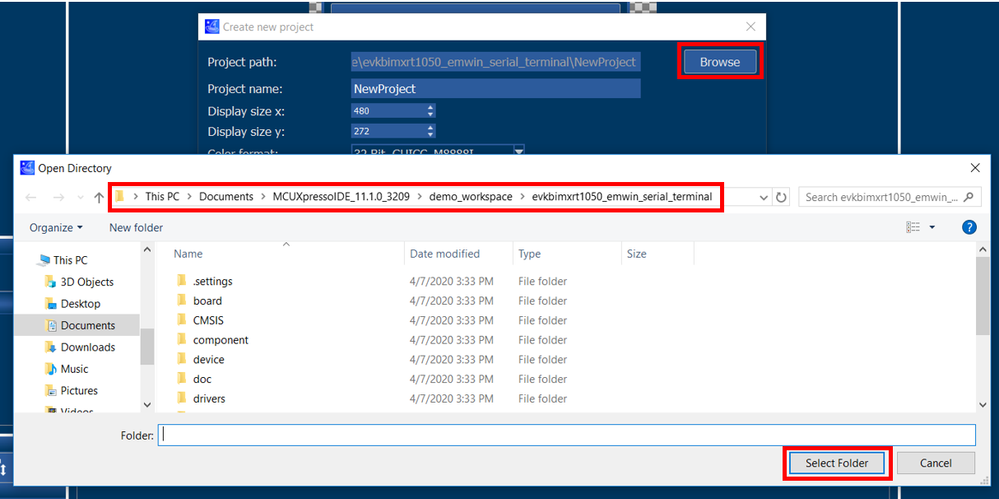

  3. Select Browse to choose a destination folder for the AppWizard generated files.  It is recommended to choose a location local to the project you just imported. This will be located in the workspace location you chose when starting MCUXpresso. pastedImage_1.png

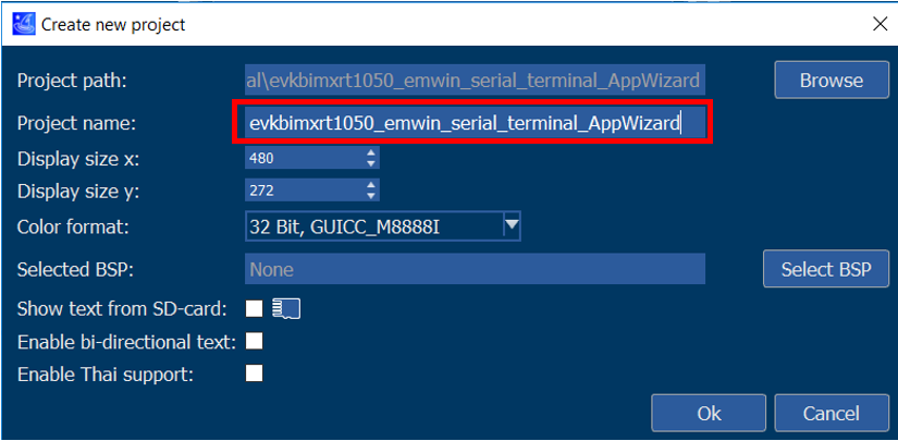

  4. The next step is to give your AppWizard project a name.  It is recommended to choose the same name as the MCUXpresso project appended with "_AppWizard" as shown below.                                                             pastedImage_2.png

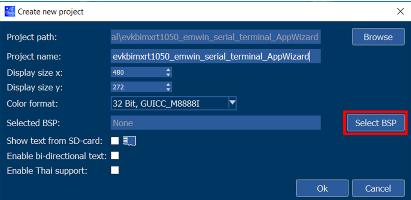

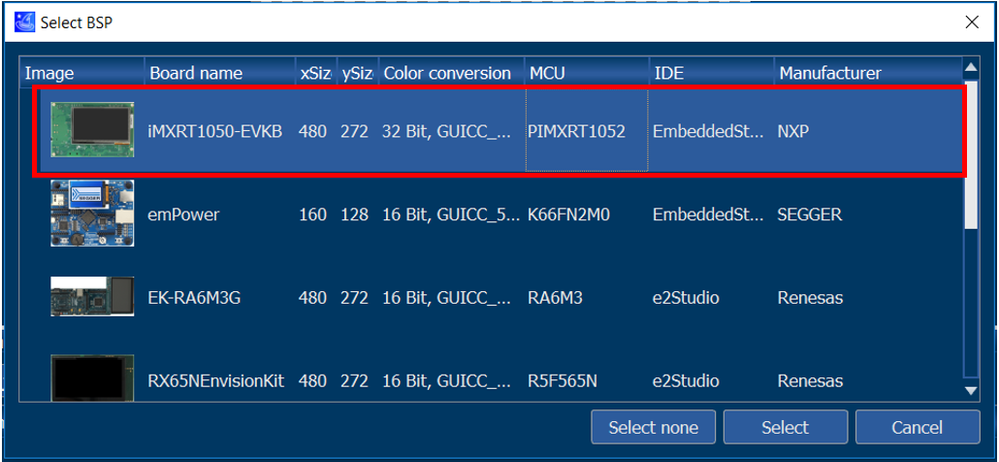

    • If you select a BSP, make sure you select the BSP for your board.  pastedImage_7.png
  6. Or manually select the display size and color format if the device and display you are using is not available in a predetermined BSP.   (NOTE:  If you don't select a BSP, you will need to create the Target/GUI_Lib folder manually to get this tutorial to work. The directions for this are presented later in the document.)pastedImage_4.png                                                                    The last three check-boxes are optional selections that enable SD-card support, bi-directional text support and Thai language support.

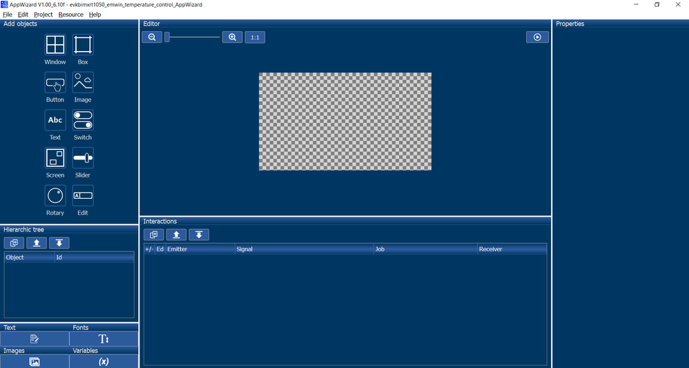

In the newly created AppWizard project, a blank canvas will be displayed.  pastedImage_15.png

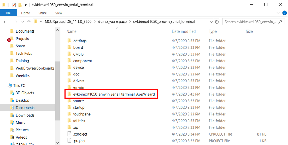

In the project folder, a new folder will be created named with the project named established in the creation of the project.
In this folder, there will be the AppWizard project you created, a Simulation folder (for holding the simulation files), Source folder (for holding the source files AppWizard will create) and a Target folder (that holds BSP files and library files).  (NOTE:  The target folder will not exist if you did not select a BSP.)

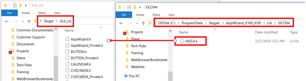

Then copy the library from <root>/ProgramData/Segger/AppWizard_<version>/Lib/GCCM4 to the Target/GUI_Lib folder you just created.  (NOTE:  You could use the library in GCCM7FP if desired, but you would need to rename the library to libGUI.a and enable floating point support. )

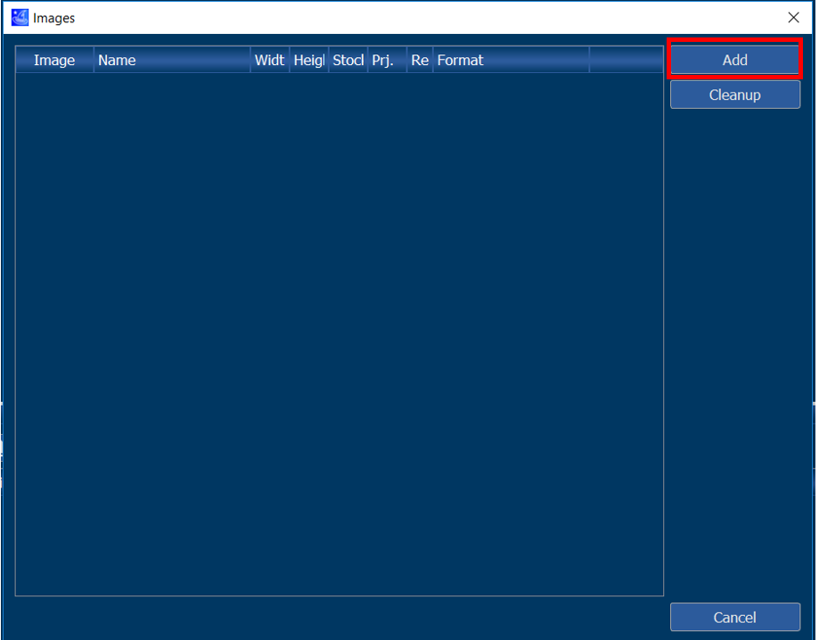

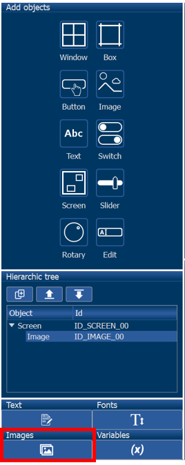

  1. Click Images on the left hand panel to bring up the Image Resource dialog box.                                                                                         pastedImage_7.png

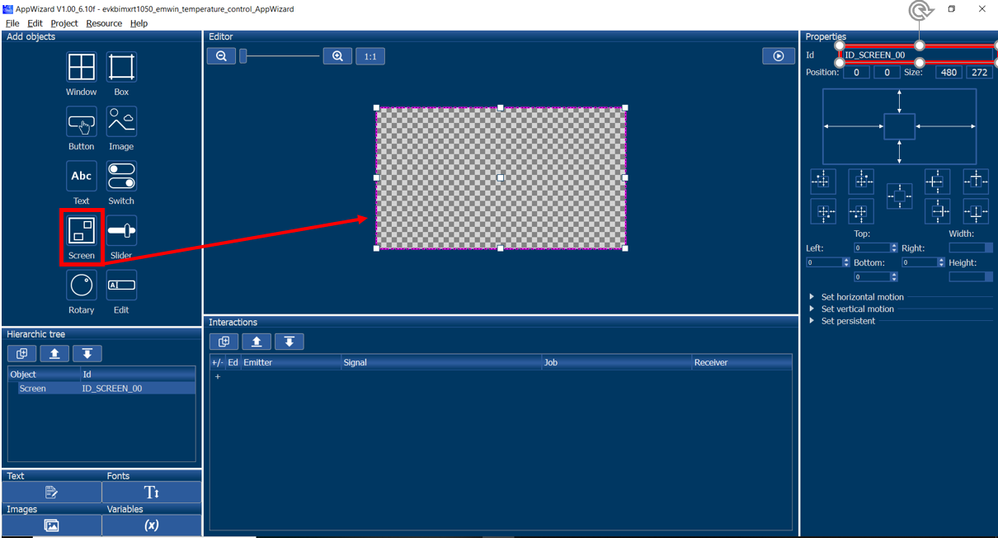

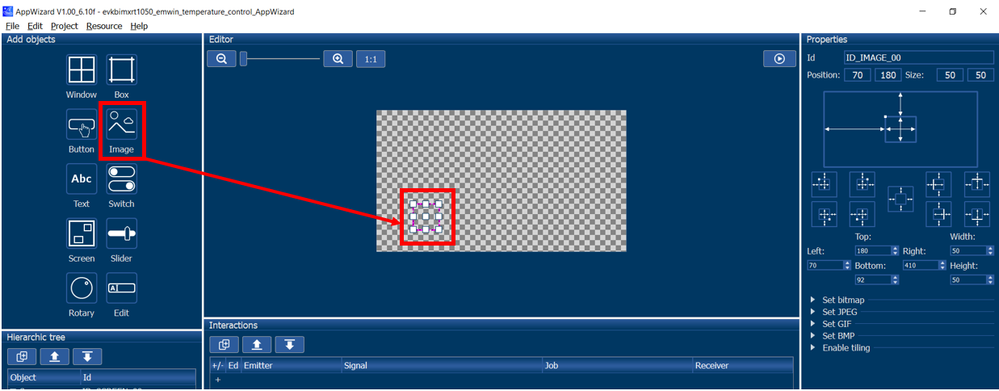

  4. Now, add an image object to the screen, by clicking and dragging the Image icon to the screen you just added. pastedImage_4.png

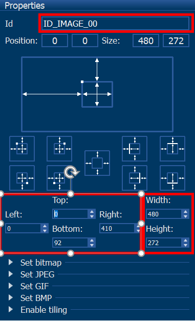

  5. With the image selected, you can change the size, position, and name of the image from the window pane on the right side of the screen. Change the height and width to match that of the size of the screen and change to 0, 0.                                                                                                                pastedImage_5.png
  6. Using this control panel, click the arrow to the left of bitmap, and then click the square underneath bitmap to set the bitmap image to use for this image object.  pastedImage_6.png
  7. Clicking the square brings up the Select image dialog box. Scroll to find the image you want to use, select it, and then click Select to use it as the image.  pastedImage_9.png
  8. The image should now appear in the project as it would appear on your screen. pastedImage_10.png

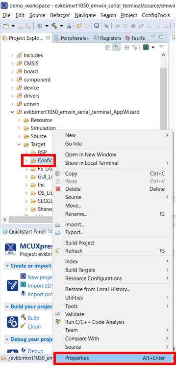

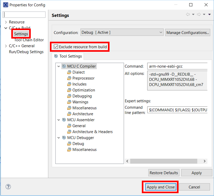

  3. Next, expand the AppWizard project folder and then expand the Target folder.  Right click on the Config folder and open the Properties dialog box.  pastedImage_7.png
  4. In C/C++ Build -> Settings, be sure to check "Exclude resource from build". Then click Apply and Close.  pastedImage_10.png
  5. Repeat steps 3 and 4 for the BSP, FS_Lib, OS_Lib, SEGGER, Shared, and Simulation folders.  pastedImage_11.png

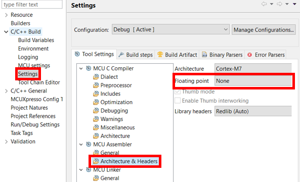

  7. In the C/C++ Build -> Settings category, select MCU C Compiler -> Architecture.  Change Floating point to None as shown. pastedImage_13.png
  8. In MCU Assembler -> Architecture and Headers, change Floating point to None as shown.  pastedImage_14.png

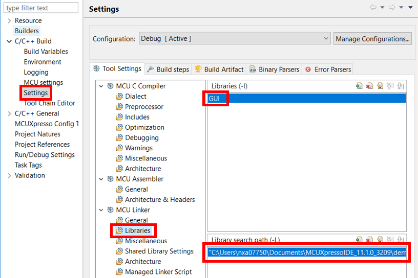

  10. Next, in MCU Linker -> Libraries, change the library to "GUI" and change the search path to the location where the library is located.  (Note that in the file system on your PC, the library will actually be named "libGUI.a".  MCUXpresso should still be set to look for GUI.  MCUXpresso will look for a file that begins with "lib" and will remove this prefix when passing this library to the linker.)   pastedImage_16.png

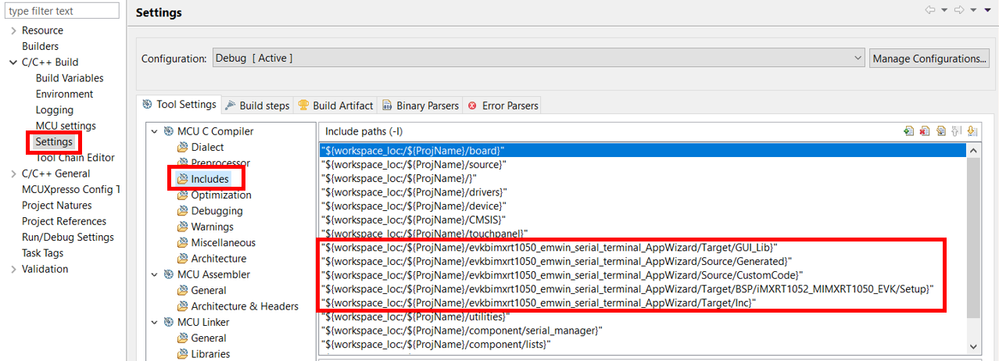

  11.  The final step in modifying the project settings is adding the include search paths.  Under MCU C Compiler, select includes and ensure the following paths are included
    • "${workspace_loc:/${ProjName}/evkbimxrt1050_emwin_serial_terminal_AppWizard/Target/GUI_Lib"
    • "${workspace_loc:/${ProjName}/evkbimxrt1050_emwin_serial_terminal_AppWizard/Source/Generated"
    • "${workspace_loc:/${ProjName}/evkbimxrt1050_emwin_serial_terminal_AppWizard/Source/CustomCode"
    • "${workspace_loc:/${ProjName}/evkbimxrt1050_emwin_serial_terminal_AppWizard/Target/BSP/iMXRT1052_MIMXRT1050_EVK/Setup"
    • "${workspace_loc:/${ProjName}/evkbimxrt1050_emwin_serial_terminal_AppWizard/Target/Inc"pastedImage_17.png

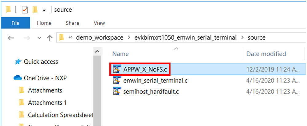

  1. Add APPW_X_NoFS.c to the project by simply copying this file into the Source folder in the file system on your PC. (Note that the APPW_X_NoFS.c file can be downloaded from the NXP emWin Libraries download tab.) pastedImage_1.png

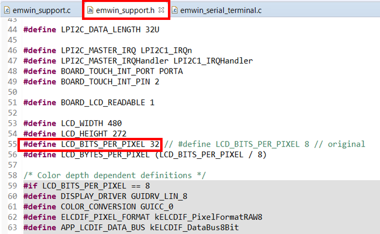

  4. Finally, open emwin_support.h (found in the board folder), change the LCD_BITS_PER_PIXEL to 32.  If you keep the default to 8, the background image will be loaded into the frame buffer because of how LCD_X_DisplayDriver was written.  pastedImage_4.png
