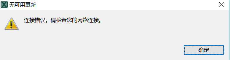

rex_lam
It seems no one has proposed how to configure the proxy and this information is not available in the user manual either. It would be best if the MCUXpresso config tool preferences window has the option to let the user enter the proxy and port settings when proxy is enabled. I have the same problem with the tool not being able to go online to retrieve processor data, and I found my solution from this thread:
Pins Tool: Could not download device information file
Specifically, adding the proxy settings to tools.ini fixed the problem.
-Djava.net.useSystemProxies=true
-Dhttp.proxyHost=somecompany.proxy.net
-Dhttp.proxyPort=80
I hope this helps others who are also on a network with a firewall.

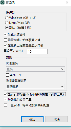

liborukropec
Hello Rex,
thank you for confirmation it helped to you. By default the application takes the proxy configuration from system (windows+linux), or can be simply configured not using the global system proxy and connect directly (in the application Preferences). This works in many cases. Unfortunately there can be many proxy/network configurations, problematic are e.g. those requiring the user authentication.
You are right that the above information could be in the documentation - we will include it in version 6.0.
For my curiosity, could you describe details about your proxy?

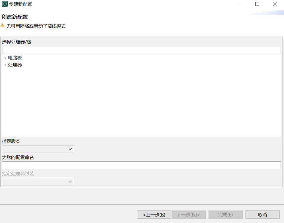

linghaokong
My MCUXpresso config Tools V4.1 can not connect internet too!!
My  internet is normal .
MCUXpresso_Config_Tools_v4.1_x64.exe

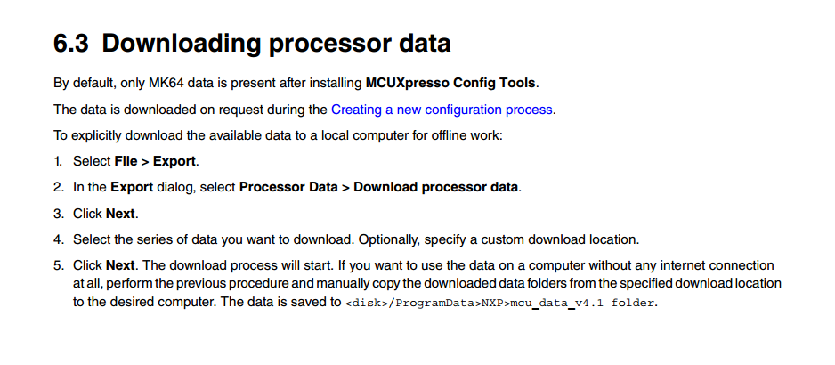

Hello Linghao,
How about turn of the  firewall of your PC.
If still can't work , you can also consider of offline mode , copy related data from another PC that can connect to
internet using MCUXpresso Config Tool , paste on your PC, about the detail steps you can refer to this thread:
How to Use MCUXpresso Config Tools on Offline Computer

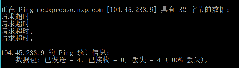

nickdolling
I have the same problem. If I ping mcuxpresso.nxp.com the IP resolves correctly (but the request times out).

liborukropec
Hello Nick,
as you noted, the corporates can have (and have) different firewalls, proxies, network configurations (like tunneling IPv6 over IPv4 or vice) and other restrictions. Just everything cannot be tested. There might be problem in our application/java or even in Windows or even misconfiguration in the corporate network. Sometimes it requires the cooperation with the user to get as most information as possible. Suggested workarounds also might identify the root cause of the problem. That's why it is important to provide the required information in order to fix the problem.
Regarding the environments which are offline by design or by other problems, we improved the upcoming version with more easy way to export downloaded data into ZIP archive on computer that is online and to import on another one which cannot download data for whatever reason.
We are also working on solution where you will be able to download the archive from the web page. This solution is not ready yet.
If you let me know what processor/board or kit you need (now I expect Config Tools v 4.1), I can create an archive for you by return.
Libor

liborukropec
the 1060 is in the archive posted above - http://mcuxpresso.nxp.com/staticdata/packages/MKL16_IMX_LPC54_v4.1.zip - please extract content of the archive into the "c:\ProgramData\NXP\mcu_data_v4.1" folder and restart the Config Tools.
Libor

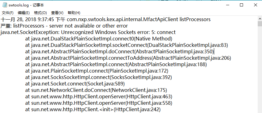

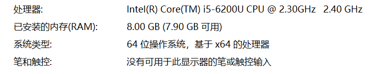

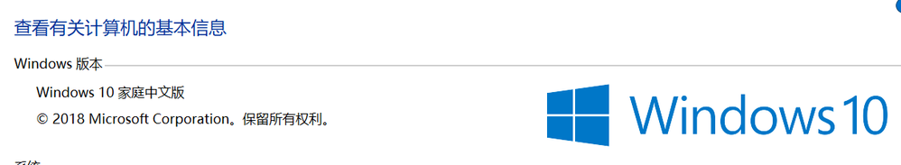

liborukropec
could you please provide more information:
1. what operating system do you use - I can see you have Windows 10, x64
2. do you use http proxy? if yes, does it require authentication?
3. do you have IPv6 enabled? if yes, could you please try appending into the <install_directory>/bin/tools.ini this line at the end of the file?
-Djava.net.preferIPv4Stack=true
4. please attach log file "c:\Users\<user>\.nxp\swtools.log" which might help
5. In Command Prompt, does it resolve the hostname into the IP address?
C:\>ping mcuxpresso.nxp.com
Pinging mcuxpresso.nxp.com [104.45.233.9] with 32 bytes of data:
Libor

liborukropec

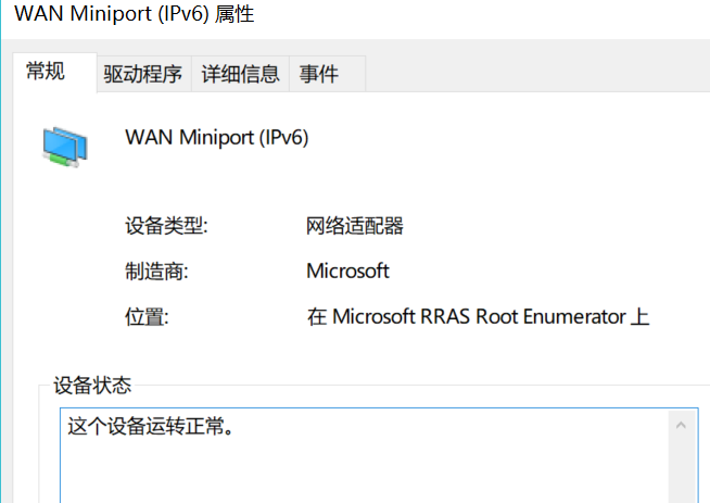

1. what operating system do you use (including 32/64 bit version)
3. do you have IPv6 enabled? if yes, could you please try appending into the <installdir>/bin/tools.ini this line?
Libor

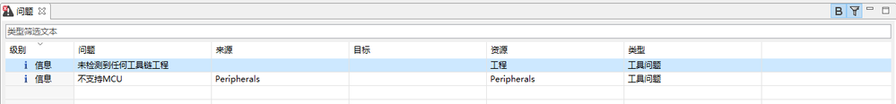

Alex_23
Maybe it's the company network. I can use the tool on my personal computer,but when I create new configuration for RT1052 .I can't use peripherals tool ,pin tool and clock tool works fine.
3,245 Views
liborukropec
did you select MIMXRT1052xxxxB or MIMXRT1052xxxxx? The first one has Peripherals support, while the second one (preliminary silicon) does not. May be there's exact error message written there, but I do not speak Chinese unfortunately. Can you share the *.MEX file here in case the processor is "MIMXRT1052xxxxB"?
Libor
3,246 Views
Alex_23
I select MIMXRT1052XXXXX,because  MIMXRT1052XXXXB not in the processor selection list.Then I try to update processor data by the way described in the picture.The selection list is still missing MIMRT1052XXXXB. Can you send me MIMRT1052XXXXB processor data?
3,246 Views
liborukropec
please extract content of the archive mcuxpresso.nxp.com/staticdata/packages/MIMXRT1052xxxxB.zip into the "c:\ProgramData\NXP\mcu_data_v4.1" folder and restart the Config Tools.
