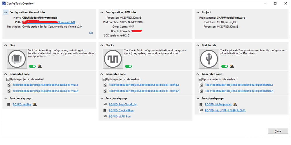

we have the following code Structure of a MCUXpresso Project.
Root/board/clock_config.c
Root/board/clock_config.h
Root/board/periperals.c
Root/board/periperals.h
Root/board/pin_mux.c
Root/board/pin_mux.h
Root/source/firmware_main.cpp
Root/Tools/bootloader/project/bootloader/board/
Root/Tools/bootloader/project/bootloader/board/clock_config.c
Root/Tools/bootloader/project/bootloader/board/clock_config.h
Root/Tools/bootloader/project/bootloader/board/periperals.c
Root/Tools/bootloader/project/bootloader/board/periperals.h
Root/Tools/bootloader/project/bootloader/board/pin_mux.c
Root/Tools/bootloader/project/bootloader/board/pin_mux.h
Root/Tools/bootloader/project/bootloader/board/firmware_main.cpp
Root/Tools/bootloader/project/bootloader/bootloader.mex
Root/firmware.mex
In the root folder there is the firmware and in a subfolder Tools there is the bootloader.
Both projects contain a .mex file. Upon code generation the Config Tools always write into the Tools/bootloader subfolder even for the Firmware Project.
Is there a way to configure in which folder the generated code is placed?
I would expect: Firmware.mex writes to Root/board and bootloader.mex writes to Root/Tools/bootloader/project/bootloader/board/.
The problem started to occur now, as we integrated boot projects into one folder tree.
1,966 Views
tsparber
I'm able to build just fine, as the bootloader subproject is "excluded from build".
I found a solution / workaround -> Exclude the Subfolder using the Resource Filters

Hi Tommy,
can you build you application?
Currently ConfigTools consider all files inside the project folder as "project files" and returns first clock_config.c that is found.
I'm not aware of any workaround, I'd recommend to split projects into two separate folders.
