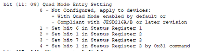

My RT1021 based design supports several compatible spiFlash types and vendors. Each of these flash parts has the QE bit at different position, apparently shown below:
Questions:
1. BLHOST does not seem to have a command or method to query the flash parts ID/vendor to configure Quad Enable bit appropriately. It appears it is OK under the assumption that the system design supports 1 flash type at a time. If different part is used in the system, BLHOST scripts have to be changed to work with a different part. Please confirm this.
2. Given (1) is true, is there any option to query the flash part ID (during runtime) to enable the QE bit appropriately for design that supports multiple compatible flash parts?
-james

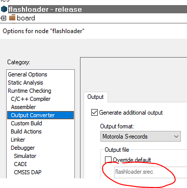

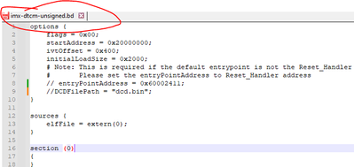

To continue pursuing the solution I mentioned above, I need to generate the ivt_flashloader.bin (?!) that is for the SDPHOST to write to 0x202A000 (and jump to 0x2020A400) to execute. And after this, flashloader will execute. Please help review my simple steps below to see if there's anything missing/wrong:
Now, IAR generates the flashloader.srec as shown below:
I'm using imx-dtcm-unsigned.bd
Use ELFTOSB to generate the final BIN with the following command:
elftosb.exe -f imx -V -c imx-dtcm-unsigned.bd -o ivt_flashloader.bin flashloader.srec‍‍‍‍‍‍‍‍‍
Here's the problem:
thanks
