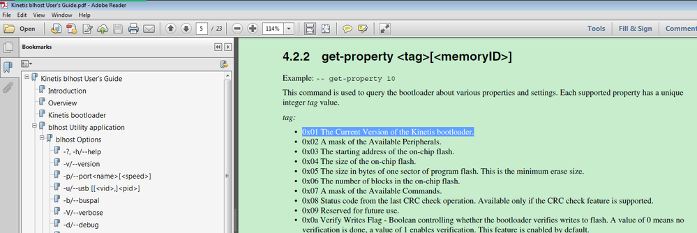

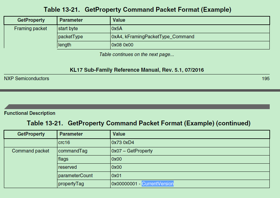

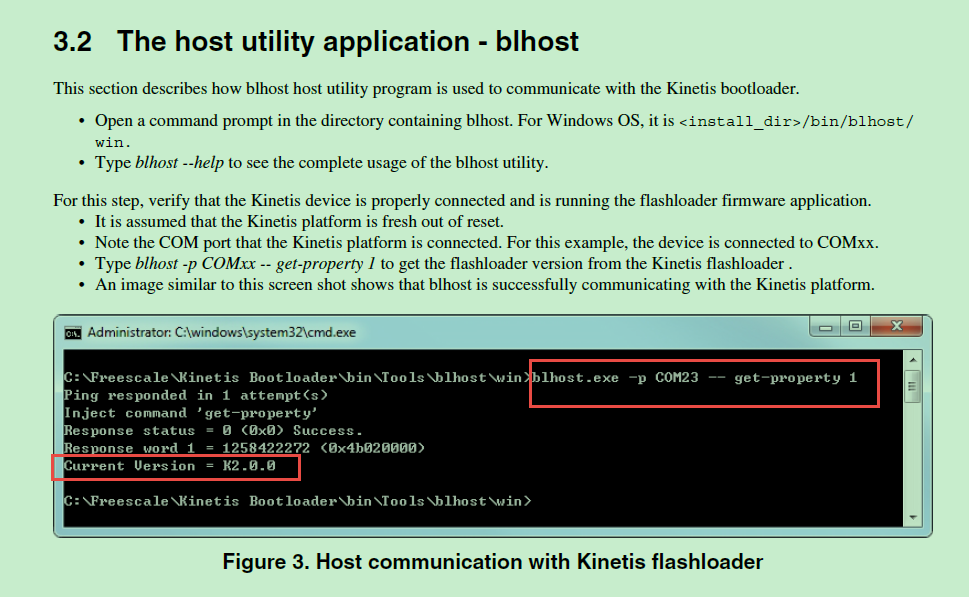

kerryzhou
Hello Andrew Royal,
   You can use the blhost to read out the ROM bootloader version.
   Commander: GetProperty , this command can get the ROM bootloader version.
Wish it helps you!
Kerry
