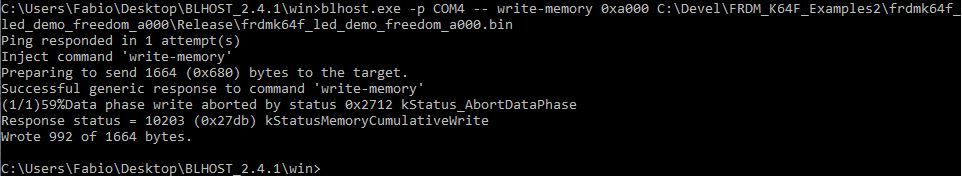

I have two different problem with Blhost tool and MCUBoot. The two problems are not related to each other.
1) If I try to load led_demo application with Blhost, loading aborted and not flash
completely the application.
All works well with KinetisFlashTool instead.
What can it depend on?

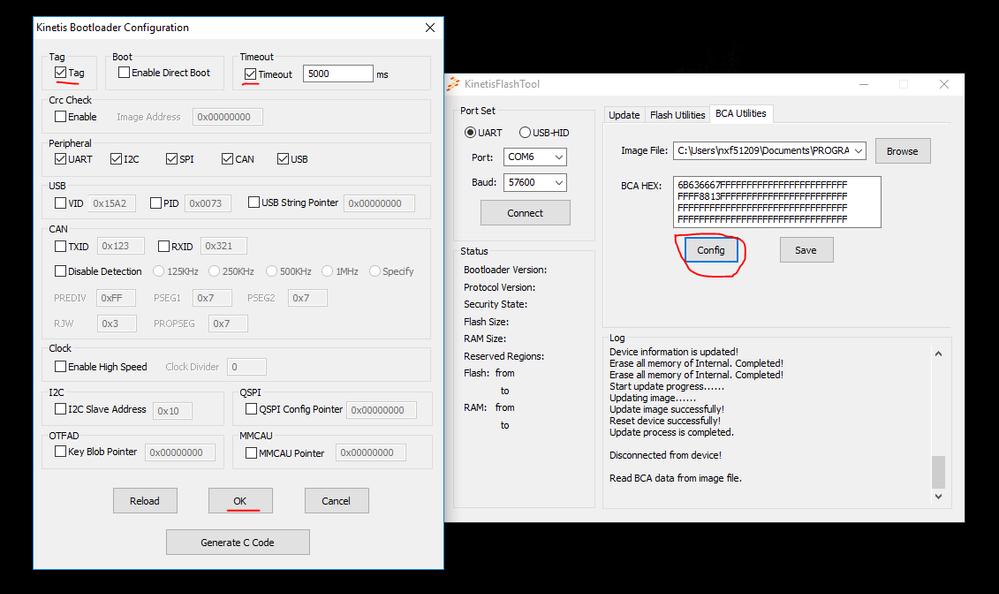

Sabina_Bruce
Hello Favio,
For the first part, I have found the problem. It looks to me that when using the blhost it is not jumping to application. I verified that in fact it was writing the binary correctly by using the execute command in blhost for the address where the application was written. At this point the board began to blink.
So I checked to see if there is BCA implemented in the application and there is not which led me to configuring a timeout in the Kinetis Flash Tool.
This will overwrite the binary that you are using and provide a timeout. Once this is done it will proceed to the application and begin blinking whether written from the blhost command or the Kinetis Flash tool.
Let me know if this works for you or if you have any questions.
