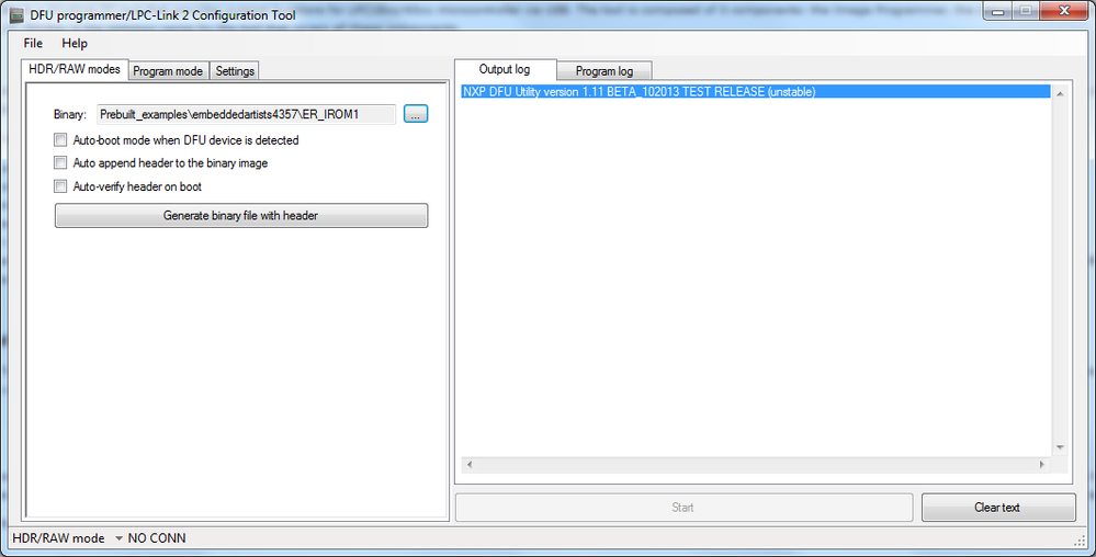

The LPC18xx/43xx DFUSec utility is a Windows PC tool that provides support functions for LPC18xx/43xx microcontroller via USB. The tool is composed of 3 components: the Image Programmer, the LPC-Link 2 Configuration Tool, and the Security Support Tool (v2.00). This tool has been called the LPC18xx/43xx DFU Utility (DFUUtil) or DFUSec in versions prior to v1.10. DFUSec is the common name for the tool that covers all these components,

The Image Programmer uses the USB DFU boot capability of the LPC18xx/43xx devices to program the internal FLASH or EEPROM, or the SPIFLASH on some boards. To do this, a small USB image is first downloaded to the board via USB using DFU and then it communicates with the PC application. To use the Image Programmer, the a USB port must be connected for USB boot with the LPC18xx/43xx device. Most commercial boards - such as boards from Embedded Artists, Hitex, Keil, and NGX - provide this support.
The Image Programmer provides the following capabilities:
  • In circuit programming and re-programming of internal FLASH and internal EEPROM on all LPC18xx/43xx devices via USB
  • In circuit programming and re-programming of some SPIFLASH devices available on LPC18xx/43xx boards
  • Smiple DFU download and execution of an image in IRAM with optional automated download whenever a board is plugged in
  • Optional checksum generation at program time
  • Boot header generation (needed by SPIFLASH or DFU boot)
  • Sequenced program operations for complex image layouts across multiple storage (internal FLASH, internal EEPROM, SPIFLASH) types - a single session can quickly program all storage with a single automated USB sessions
  • Extendable FLASH support - add support for other storage devices in the programming algorithm firmware

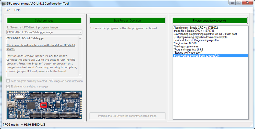

LPC-Link 2 Configuration tool
The LPC-Link 2 Configuration Tool is used to load firmware images onto the LPC-Link-2 board ir LPCXpresso V2 boards with the integrated LPC-Link 2 (LINK DFU) interface. This allows loading a firmware image that supports debugging via USB such as JLINK or CMSIS-DAP for development environments other than the LPCXpresso-IDE. To use the tool, select an image for a support LPC-Link 2 boards and follow the in-page instructions. 146759_146759.pngpastedImage_2.png
