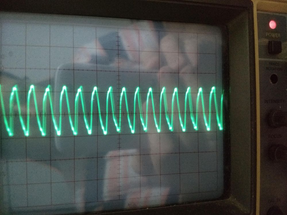

Hi, I set up a DMA to transfer data over I2S.0 in my lpc4337. Alsignals look OK (SCK, WS and SD), but the MCLK signal is only 1v, and it does NOT look square at all.
This is the output of a 20Mhz the oscilloscope I have at home:
500mV x 0.2uS
mclk signal is about 5mm of distance from the board pin and it can't get any closer. I used to have a protoboard with a lot of long cables, and the signal looked like the one below, but that's no longer the case.

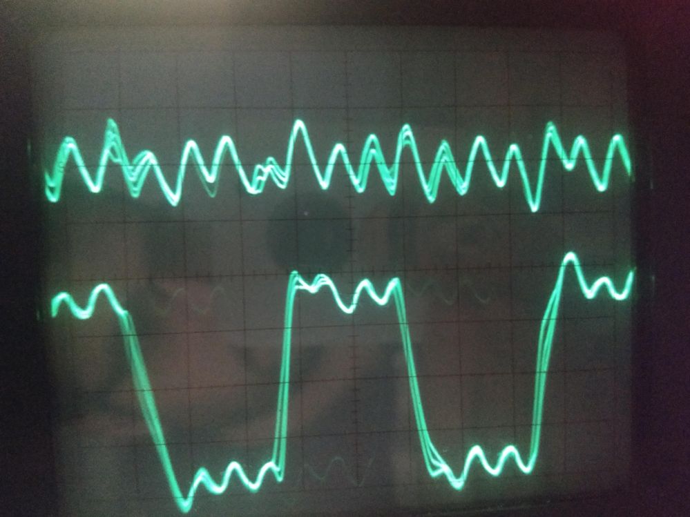

MCLK and SCK with very long cables on a protoboard. 1V x 0.2uS.
Ignore this picture as this is no longer a problem.

Regarding the question that "the MCLK signal is only 1v, and it does NOT look square at all.", it appears that the Oscilloscope bad pass-band leads to the issue for example distort and low voltage, maybe the original signal is okay. If possible, can you use another digital oscilloscope to have a test?

Hi, thanks for the reply. I will assume my oscilloscope is not showing the right voltage for such high frequencies.
