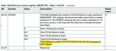

I did also get the information that hardware hashing is limited to 2047 blocks each 512 Bit which does indeed result to ~130000 Bytes. Thats also the point where hashcrypt generates wrong hash values for me. (See screenshot from LPC55xx user guide)
Can you tell me where this limitation comes from? From my understanding hashing should be possible for as big data as you want.

Hello @TestNXP
Please use latest  version SDK v2.14.0.
