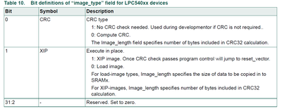

Hi, Oliv,
Regarding your question, you said your board was working when copying flash to SRAMX then executing code from SRAMX, do you mean that your board can run after Reset even power off/on? I assume that you have downloaded application code to SPIFI flash. If it is the case, I think the boot process is okay.
The only difference between the XIP and SRAM executing is the XIP bit setting for image type(__imghdr_imagetype variable in *.ld file).
Hope it can help you

I already checked that bit in the header and it is correctly configured:
Address 0x160 contains (little endian) a5a5 edfe 0300 0000 0000 0010 0439 0000 =>
Header_marker: 0xFEED A5A5
image_type: 0x0000 0003 (No CRC computation, XIP image)
load_adress: 0x1000 0000 (SPIFI XIP)
Image_length: 0x0000 3904
So, if that bit is correctly set and the boot process is correct when booting from SRAM: why NXP SDK board is booting in XIP mode but not mine ? Could we have any race condition between peripherals, like clock startup time ?
