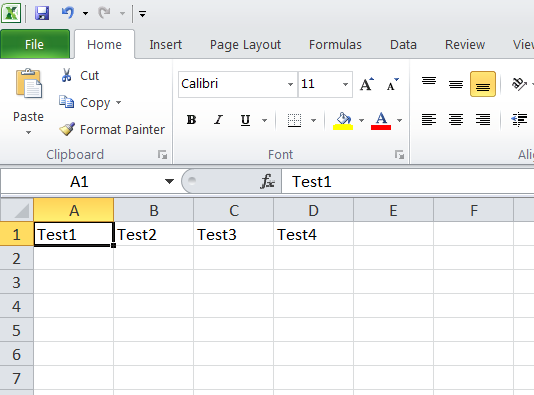

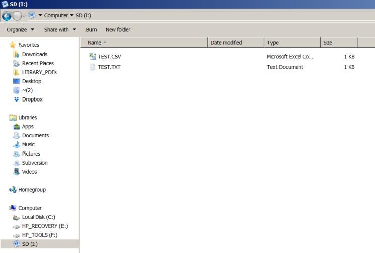

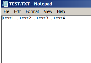

jameswhitney
Kerry,
Thank you for your reply.
After your response I re-checked the connection to the microSD card connector/board headers. Indeed, on header J1 I had connected signal 'DI' to J1-14 - please blame bad eyesight. Once I connected to J1-13, *ALL IS WELL*.
Just to answer all of the questions you've asked:
- sd fatfs code: Code from thread "https://community.nxp.com/thread/476560 " - RAR file from 6/22/18
- Board: NXP LPCXpresso54114
I have inserted 3 screen captures of my results.
Thanks, so much, for all your help.
Jim
