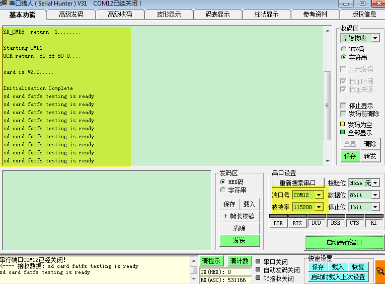

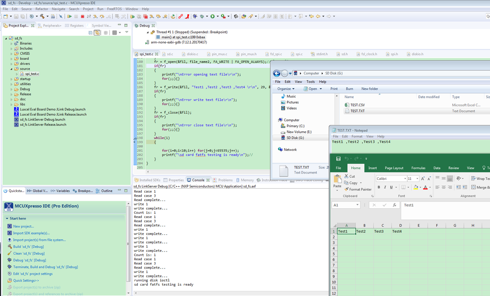

  Good news, after I lot of modification, it works now, check the result:
You can find after running the spi sd card code with fatfs file system, we can create two files in the SD card, and write some Test data in the according files.
Now, please check my attached project on your side, whether you can make it works or not?

      The code in the last project will printf the log in the IDE debug console window, if you want to printf to the serial tool with UART, please use the project in this attachment.
      This code will printf the data to the lpcxpress LPC54114 on board virtual COM port, you can check the log in the serial tool.

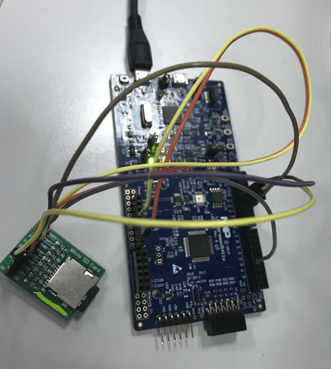

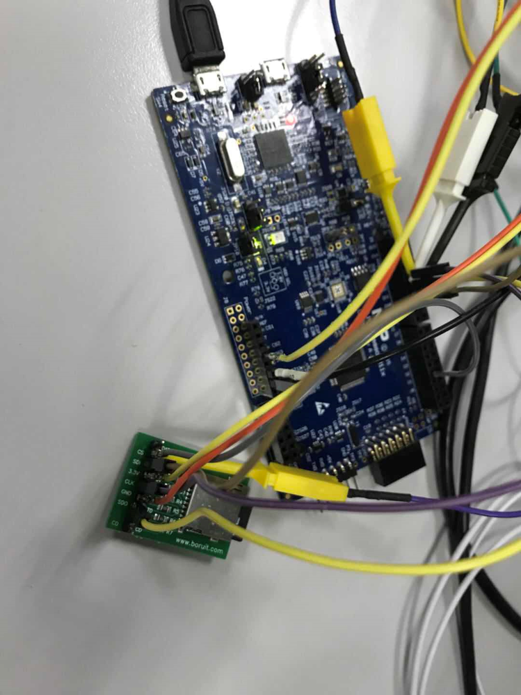

1. Hardware:
     LPCXpress LPC54114 board, revA.
     SD card slot board.
    SD card pin to the LPC54114:
  • CS --> port0 pin10, J2_11
  • MISO --> port0 pin18, J1_11
  • Clock --> port0 pin19,J1_9
  • MOSI --> port0 pin20,J1_13

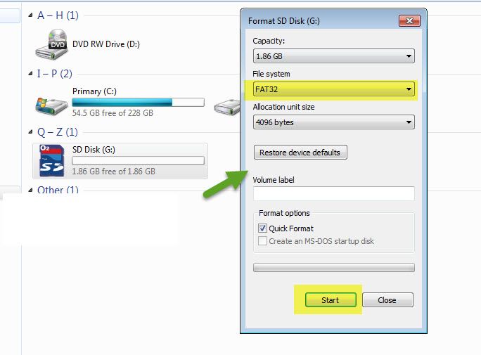

2. Format the SD card to FATfs32 in the PC at first.
3. Download the code to the LPCxpress54114 board, insert the the SD card, then press the reset button, you will find some printf log in the UART console
Some customer want the printf the data in the debug console window, then they just need to do the following configuration in the quick settins:
After you get "sd card fatfs testing is ready" information, it means the fatfs already complete the sd card file create and write operation.
This code function will create two file: TEST.csv and TEST.TXT file in the SD card, and write the Test1, Test2, Test3, Test4 in each file, you can see it in the above picture.

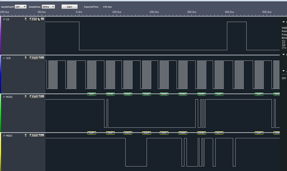

   I get some progress today, I check the low level sd card driver step by step, and find a lot of bugs: SPI high and low speed, Get_Byte, SD initialization code, MMCReadSingleBlock ect. And I modify it.
   Now, I have finished the detail checking and modification for MMCInit(). MMCReadSingleBlock(), MMCWriteSingleBlock(). All these function can works OK now.
  I have tested it associated with the logical analyzer, check the SPI bus data, and then read and write the SD card sector, compare the SD data got by the code and the PC winhex software.
  Now, post some example:

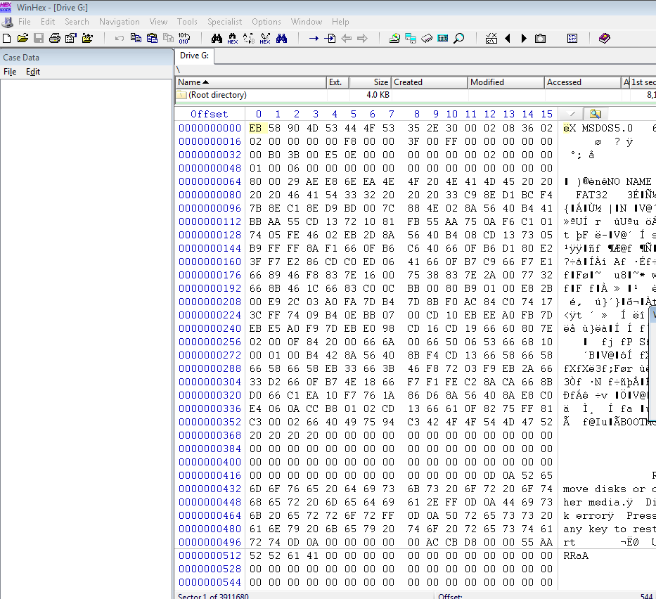

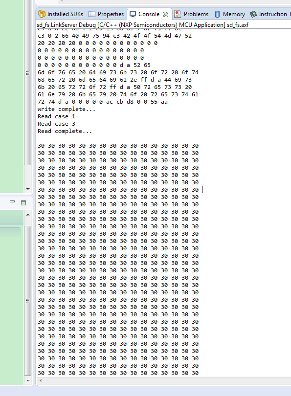

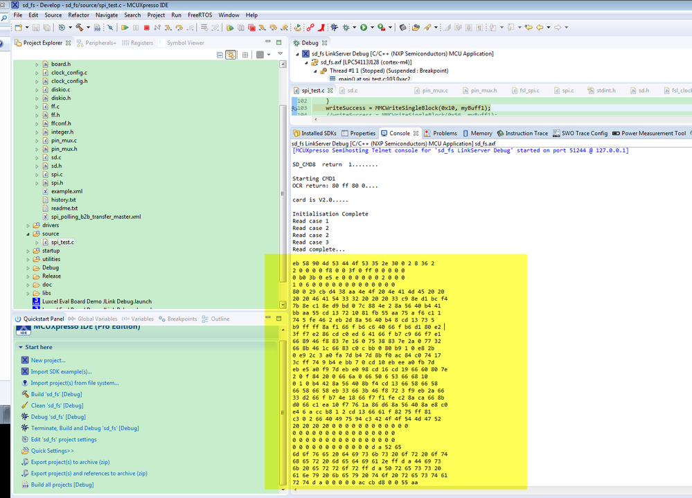

1. sector 0x00, 512Byte data
WinHex data from PC after reading the SD card
Code debug data:

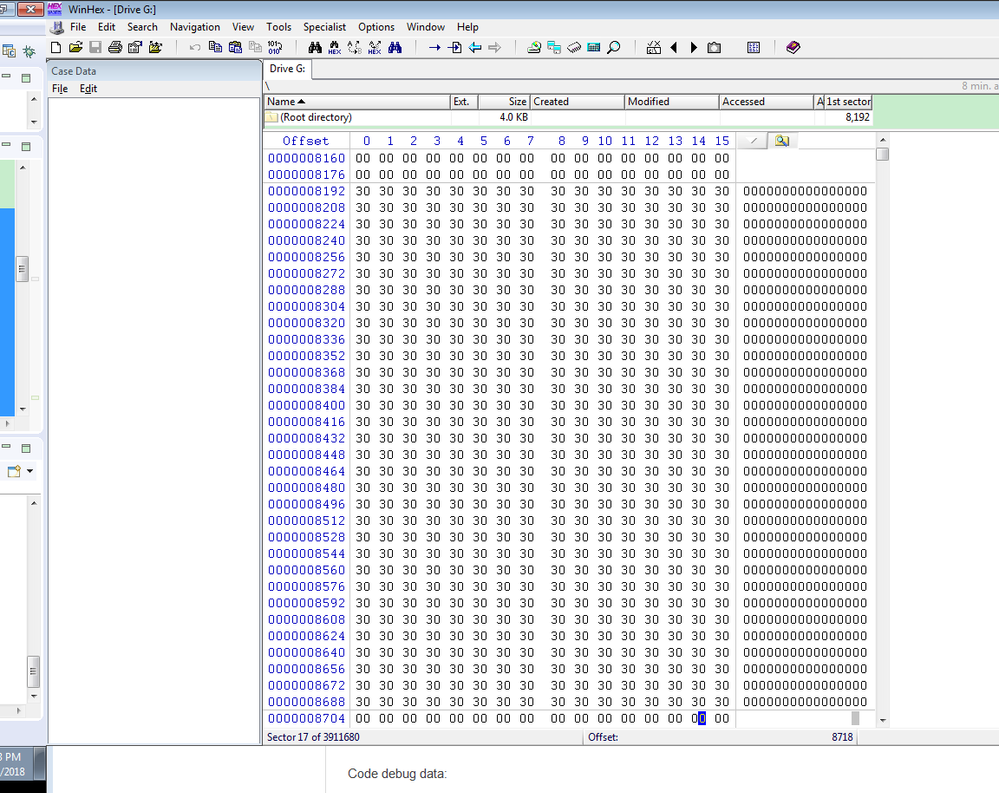

2. sector 0x10, 512Byte data
Code debug data:
So, now, the key function MMCInit(). MMCReadSingleBlock(), MMCWriteSingleBlock(). can work correct now.

    I use the same SD card pin as you:
   I am testing it now, with the SPI sd card wave checking, just want to check where you may have problems.
