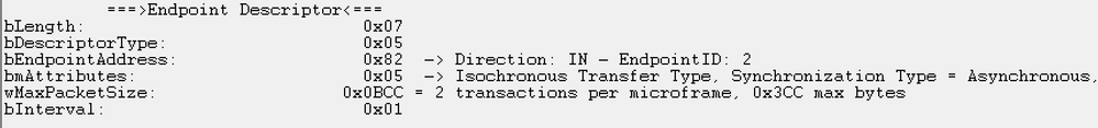

I have tried changing the "wMaxPacketSize" in the endpoint descriptor to request more transactions. The endpoint descriptor successfully shows up in Microsoft USBView as supporting "2 transactions per microframe". Unfortunately, this does not cause the computer to poll more than once a microframe.Screenshot 2021-08-18 154816.pngScreenshot 2021-08-18 154816.png

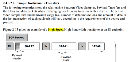

I suspect that something else needs to be changed related to the Packet IDs. For only a single transaction per frame the USB driver only has to send DATA0 packets. In order to successfully do more than one transaction per microframe the driver needs to send DATA1 and/or DATA2 packets (see the image below from the USB-Video specification). Unfortunately I have not yet found a way to change the packet ID in the source code.
Is there any way to enable sending more than one transaction a microframe for the USB-HS interface in device mode on the LPC55S2x?

Case 1: The ISO IN MPS is 512 (less than 1024) and 2 additional transactions (total 3 transactions) per micro-frame.
              Win10 will not poll more than once in one micro-frame as your  description. I think it is the  customers case.
Case 2: The ISO IN MPS is 1024 and 2 additional transactions per micro-frame.
              Win10 will poll more than once in one micro-frame, and the ip3511 (HS USB) controller seems to  work well.
Case 3: the ISO IN MPS is 1024 and 0 additional transactions per micro-frame.
              This is one IP issue and confirmed by design. Tested on  LPC55S28, where the IP3511HS controller has not interrupt when                            transferring 1024 bytes of data.
So only the Case 2 can work. Because the case 3s IP issue, we didnt do much additional transactions test in SDK USB stack, there need one patch to implement it and it is attached. The patch, attached in this reply  is based on the 2.10.0 SDK.
Please notice that: we dont do much test for the IP3511HS controller additional transactions function. Since the case 3 IP bug, we cannot guarantee that the additional transactions can always work well for some corner cases, our customers can try it and do more tests.
You need call USB_DeviceVideoSend() API function  with at least the data that need be transferred in one micro-frame. For example:
  1. There are N (N <= 1024*3) data that need be transferred in one micro-frame, the all N data need be passed to USB_DeviceVideoSend, then controller will transfer all the data to Host in one micro-frame.
  2. There are N (N > 1024 * 3) data that need be transferred.
    1. The all N data can be passed to USB_DeviceVideoSend, then controller will transfer all N data in multiple micro-frames.
    2. The 1024*3 data can be passed to USB_DeviceVideoSend firstly, it will be transferred in one micro-frame. Then pass the remaining data to USB_DeviceVideoSend again.
