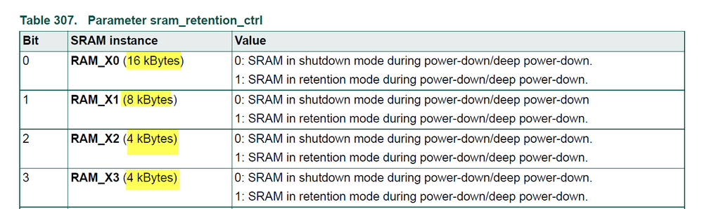

ZhangJennie
Eugene,
The size of RAM_X0 to RAM_X3 is not same, see table 307 in UM
So 0x1400 6000 to 0x1400 65FF  ( CPU retention area ) is inside RAM_X2 instance.

ZhangJennie
config sram_retention_ctrl is used to set retained RAM.
for example, with below code, RAM instances RAM_X2 & RAM_X3 content will be retained.
sram_retention_ctrl = LOWPOWER_SRAMRETCTRL_RETEN_RAMX2 |
LOWPOWER_SRAMRETCTRL_RETEN_RAMX3;
this chip doesn't have feature to set large contiguous area of SRAMX for CPU retention area.
