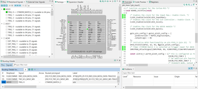

4,535 Views
danielholala
Senior Contributor II
Dear @RaRo ,
as ADC Trigger sources get routed through the Input Multiplexer, I wonder where in Config Tools do I configure these ADC Trigger sources?
Thanks.
4,504 Views
RaRo
Hello @danielholala,
You could configure the ADC and the Trigger Source (e.g. CTimer) with ConfigTools Peripherals.
The INPUTMUX routing could be made through ConfigTools Pins, search for ADC0 -> TRIGx. Select the trigger source number you need and choose the trigger source which would create the INPUTMUX routing in the Code Preview.
[ConfigTools Pins -> INPUTMUX Trigger Sources]
Best regards, Raul.
4,435 Views
danielholala
Hi @RaRo ,
That's helpful. Thanks. I overlooked the "Peripheral Signals" tab of the Pins Tool.
Cheers
