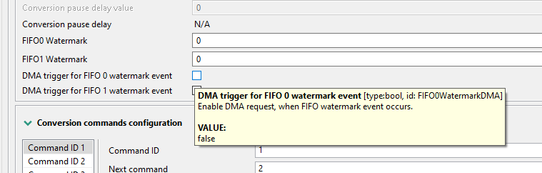

What is needed to trigger DMA operation when ADC watermark level is reached?
In ADC peripheral I set FIFO0 Watermark to 7 and check DMA trigger for FIFO 0 watermark event. Do I need to configure something else in MCUXpresso Config Tools?
I have already working code, when I trigger DMA in software by calling DMA_DoChannelSoftwareTrigger(DMA0, 21). I do that in ADC interrupt, which I configured to be called on FIFO 0 watermark level (same as DMA trigger), however if I don't trigger DMA manually, ADC interrupt is called indefinitely because DMA is not called to read from FIFO. When I turn off ADC interrupt, DMA is not triggered at all.
I would like to trigger DMA on FIFO 0 watermark, so that no ADC interrupt needs to be called, just a callback from DMA, in which I can set flag, that copying data from ADC is done.

I have seen that example before, but there is no solution to my problem. In the example LPC55S69_Project_multi_channel_DMA the DMA transfer is triggered by software in the main loop (other examples don't use DMA at all). What I would like to achieve is to trigger DMA transfer on the FIFO watermark event, that's how I understand that option in MCUXpresso Config Tools (ADC options, at the bottom of "General Configuration" field).

Hello arekp,
Yes, you are right, you need enable it in ADC configuration.
Also in DMA part, shoose the right DMA request:

Hi, @Alice_Yang
Yes, that's what I have set in my configuration, but it still doesn't trigger the DMA when the ADC FIFO0 reaches watermark level.
Is there still something wrong with my configuration? Can you point me to a working example (it doesn't matter if everything is in the code or the code is generated by MCUXpresso Config Tools).
