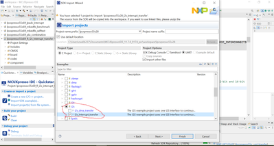

From your description, I see that you want to use two LPC5569-EVK boards to implement the I2S communication.
In the SDK package, there is I2S master example
For the I2S slave, you can develop the slave I2S example based on the master example.
static i2s_config_t s_RxConfig;
I2S_TxGetDefaultConfig(&s_RxConfig);
s_TxConfig.divider = DEMO_I2S_CLOCK_DIVIDER;
s_TxConfig.masterSlave = kI2S_MasterSlaveNormalSlave; //DEMO_I2S_TX_MODE;
I2S_TxInit(I2S6, &s_RxConfig);
In the slave mode, the SCK and WS for I2S6 will be input pins, you can assign the I2S6 pin in the pin_mux.c
Hope it can help you
XiangJun Rong

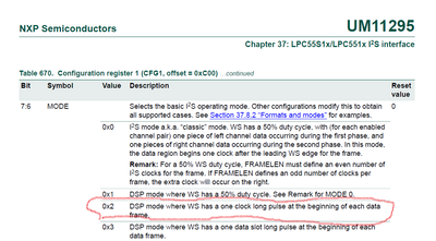

Can LPC support config I2S bitdepth?
I saw SDK support set I2S datelen and framelen only.
1,970 Views
xiangjun_rong
what do you mean for the " I2S bitdepth"? do you mean that the WS occupies only one SCK cycle instead of 50% duty cycle? if it is the case, of course, it supports the WS occupies only one clock cycle of SCK.
As the following Fig, the WS width is controlled by MODE bits.
XiangJun Rong
