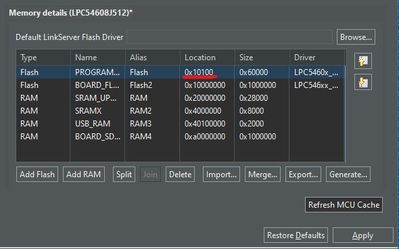

if the flash code of the main App runs @0x00000 address the lwip code works correctly, if the flash address has an offset, i.e the project of Main App is located @ flash address 0x10100 the lwip doesn't run correctly.
I'm missing something or should I set some particular options when i relocate the lwip and my main app code to another flash address (for the 2-steps bootloader)?
Just to test and replicate this problem, I have create and attached 2 projects for the EVB-OM13092 that replicate exacly my situation:
  1. lpcxpresso54608_bootloader:
    this project emulate my small bootloader @0x000 flash address, it simply print a string to the semi-host console and jumps to the MainApp code @0x10100 (just flash this code first to the OM13092 ev-board memory)
  2. lpcxpresso54608_lwip_dhcp_bm_flashoffset:
    this is my MainApp @0x10100 flash address that replicate the problem. As you can see this is exactly the baremetal example lpcxpresso54608_lwip_dhcp_bm from the sdk, as expected if this code runs @0x00flash addres it works well, but when it is compiled and flashed @0x10100 via the right MCUSettings dialog and after the correct jump from the bootloader, it doesn't run because it start the dhcp procedure but it doesn't seems to receive any dhcp answer packets.
In the picture the offset setting for the Main App example @ 0x10100 flash address location

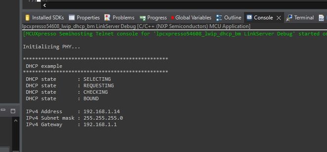

Here after the terminal screenshot of the example DHCP code from SDK running from 0x00 (good working)

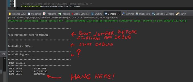

and here after the terminal screenshot of the example DHCP code from SDK running from 0x10100 (not working, it hang in the checking state)
Here after the terminal reports when I enable the DHCP and UDP lwip debug options in lwipots.h
[MCUXpresso Semihosting Telnet console for 'lpcxpresso54608_lwip_dhcp_bm_flashoffset LinkServer Debug' started on port 50496 @ 127.0.0.1]

After this it can't complete the CHECKING state, so it can't BOUND and complete the dhcp process.
Is there something wrong on relocating the SDK dhcp example (and lwip library) at flash address different from 0x00? I'm missing some memory definitions for lwip? Are there some structures in lwip stack that should be manually relocated in memory or flash?
