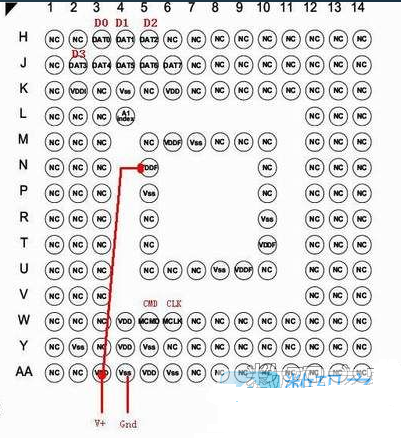

I use board sch is:
Remove CN2
D0 D1 D2 D3 CMD  CLK VDD  VSS connection eMMC
V+ connect VDD         Gnd  connect Vss

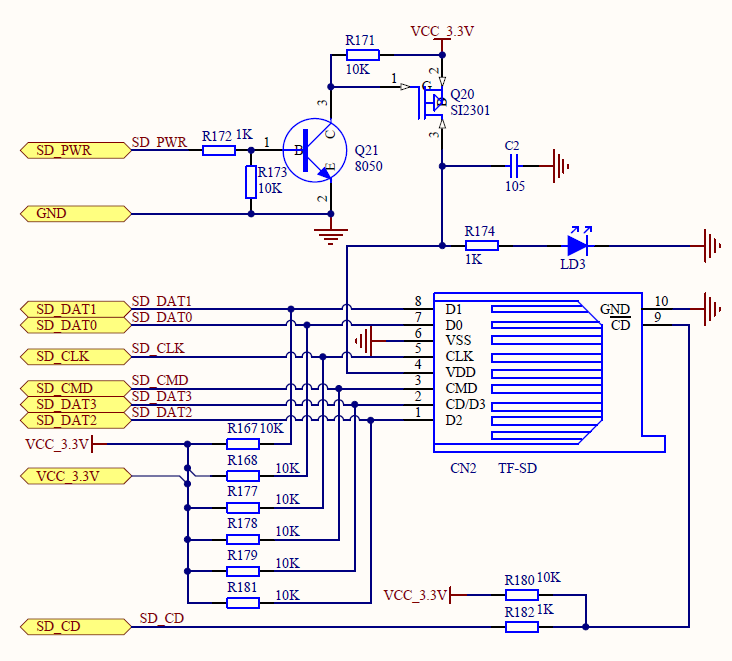

The demo works well on my site.
So I've attached the sch of the LPC1788 develop kit and the responding code, please refer to them for details.

  I use samsung emmc chip is KLM4G1FE3B  I change I change the circuit as well as you
D0 D1 D2 D3 CMD  CLK VDD  VSS connection eMMC    V+ connect VDD         Gnd  connect Vss

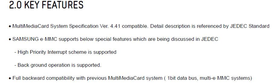

I have gone over the datasheet of the KLM4G1FE3B and LPC1788.
I find that the MCI Module conforms to the Multimedia Card Specification v2.11, and the KLM4G1FE3B should work in 1 bit data bus to full backward compatibility with the previous MultiMediaCard system which includes the Multimedia Card Specification v2.11.
So I think you need to adapt the demo code to this feature.

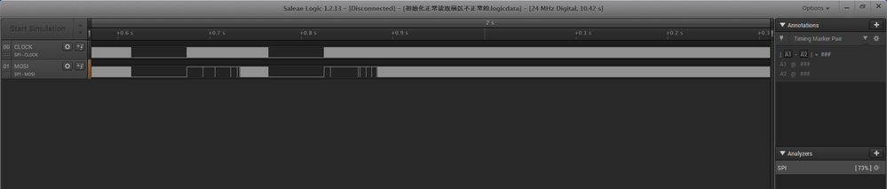

To figure out the root cause of the issue, you need to check the sequence of reading data by referring to the attached document: Embedded MultiMediaCard (eMMC) eMMC/Card Product Standard, High Capacity, including Reliable Write, Boot, and Sleep Modes, and you'd better to capture the wave of DATA0 pin via the oscilloscope or logical analyzer, the wave absolutely will give some inspiration.

I found that the error was seen by using a logic analyzer
But for the 1788 SDIO peripherals to use, in accordance with the bottom of the waveform drive is too inconvenient
According to the existing SD drive speculation
and I do not know 1788 sdio peripherals register details of the operation, the bottom of the 1788 drive up too painful
