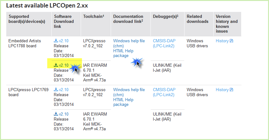

ZhangJennie
Hi Fredrik Johansson
You can use v2.10 IAR EWARM 6.70.1 Keil MDK-Arm® v4.73a from this url. it includes the USB MSD demo also
LPCOpen Software for LPC17XX | NXP
the document link is also listed. Besides, we don't have other doc for this package
Jun Zhang
