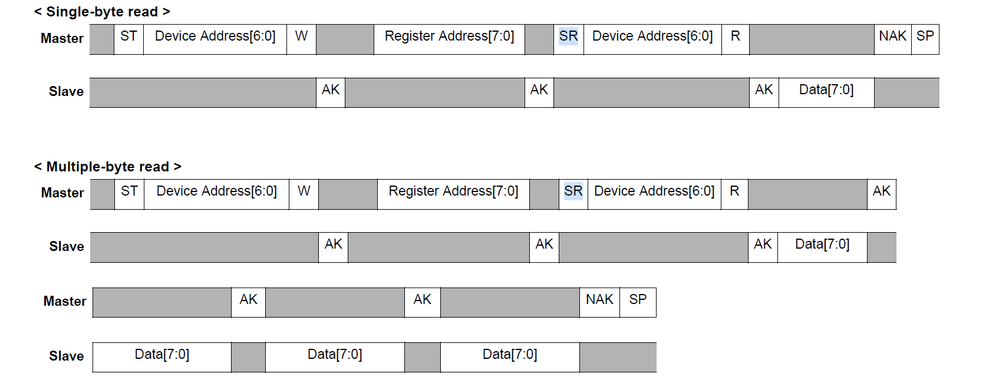

For a project I am using an LPC824 MCU from NXP and I want to read out data from the accelerometer over I2C. This accelerometer is the MMA8453Q. Looking into the datasheet of the accelerometer I see the following:
From my understanding this means that you give a start signal, you write the device address and put write behind it, you get an acknowledgement and so on.

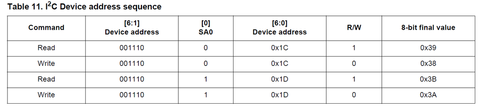

The address I have to write is the following:
the register I chose for now was 0x0D which is the "Who am I" register, this should always be read as 0x3A.

Essentially we need to make sure here that you send the following sequence:
1. Start Condition
2. 0x1C
3.Write(Bit is 0)
4. Receives ACK
5. 0x0D (Who Am I)
6. Receives ACK
7.Start Repeated Condition
8. Read(Bit is 1)
9.Receives ACK
10.Receives Data
11. NAK
12. Stop Condition
