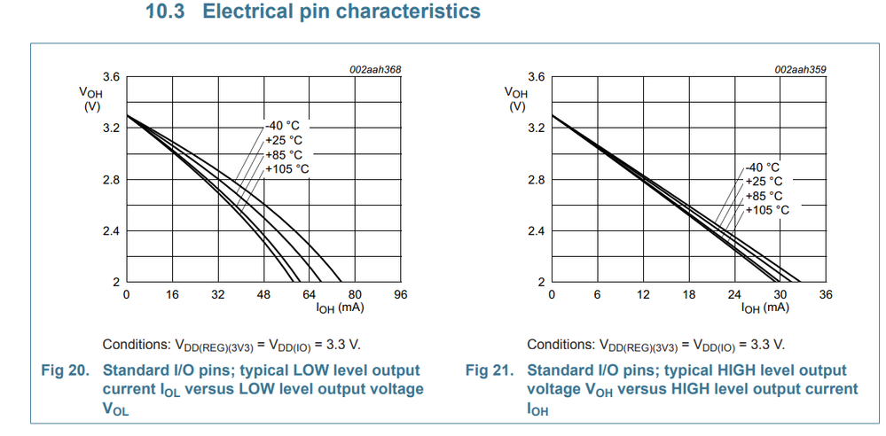

Pavel_Hernandez
Hello, I reviewed the Datasheet of this LPC this chart is the voltage of use, I do not about the design of the PCB in specific voltage.
I recommend review the chapter 10.2 Peripheral power consumption LPC435x/3x/2x/1x Product Data Sheet (nxp.com)
Let me know if you have more doubts.
Pavel
