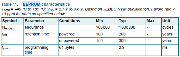

volkan_coskun
Also, how long does it takes for reads and writes when using EEPROM.
I could not really find it in the datasheets while I was looking.
regards,
Volkan Coskun

jeremyzhou
1) Is there any way to add an interrupt handler for the IAP EEPROM library that is used?
-- No, I'm afraid not, in addition, there's a suggestion below from the AN11511.
During EEPROM write and read operations, the interrupts must be disabled for proper IAP operation.
2) The dynamic characteristics of the EEPROM.
TIC
