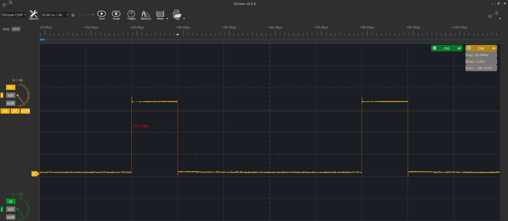

4  Test Result
Input a signal as below into channel 0 (P1_0), pulse width is 10us.

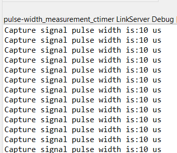

Print the measurement results on Console view of MUXpresso IDE:
