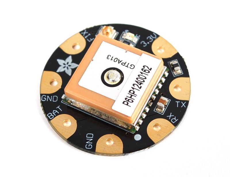

Adafruit Flora Wearable GPS
The module used for this example is built around the MTK3339 chipset, a no-nonsense, high-quality GPS module that can track up to 22 satellites on 66 channels, has an excellent high-sensitivity receiver. It can do up to 10 location updates a second for high speed, high sensitivity logging or tracking. Power usage is very low, only 20 mA during navigation. Adafruit took this module and mounted it on one of their super-compact Flora boards, which are very easy to connect up to the LPC845 Breakout:

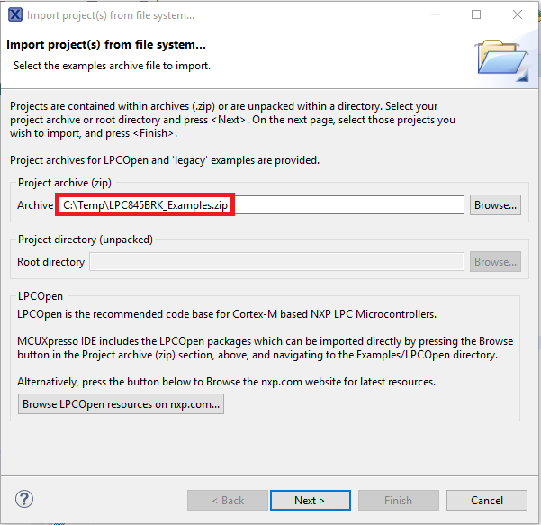

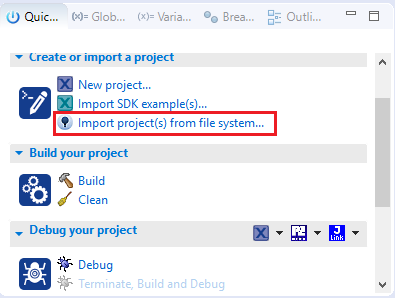

Once downloaded, we import the library project into the workspace using the ''Import project(s) from file system... from the Quickstart panel in MCUXpresso IDE:
Figure 2. Import projects
Then browse the examples packages archive file:

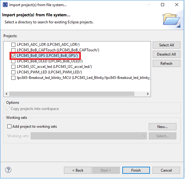

Press next, and see that are a selection of projects to import, in this case, only keep select the LPC845_BoB_GPS how it looks in the picture below:
Figure 4. Select GPS project

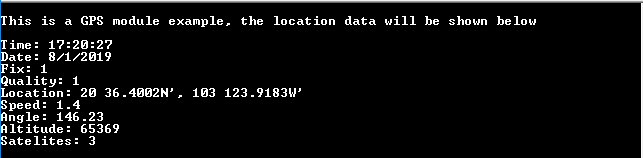

Place the GPS module outside. Once the GPS has located the satellite data, the red LED on the GPS will stop blinking. If you see the LED blinking once a second, it does not yet have a fix! It can take many minutes to get a fix if the module sees any satellites immediately.
Once it has a fix, press the user button (K1) to display the GPS data in the serial monitor, which includes the current date and time in UTC. It will also give you your latitude, longitude and approximate altitude with the Serial monitor.
Figure 6. GPS Print Out.
