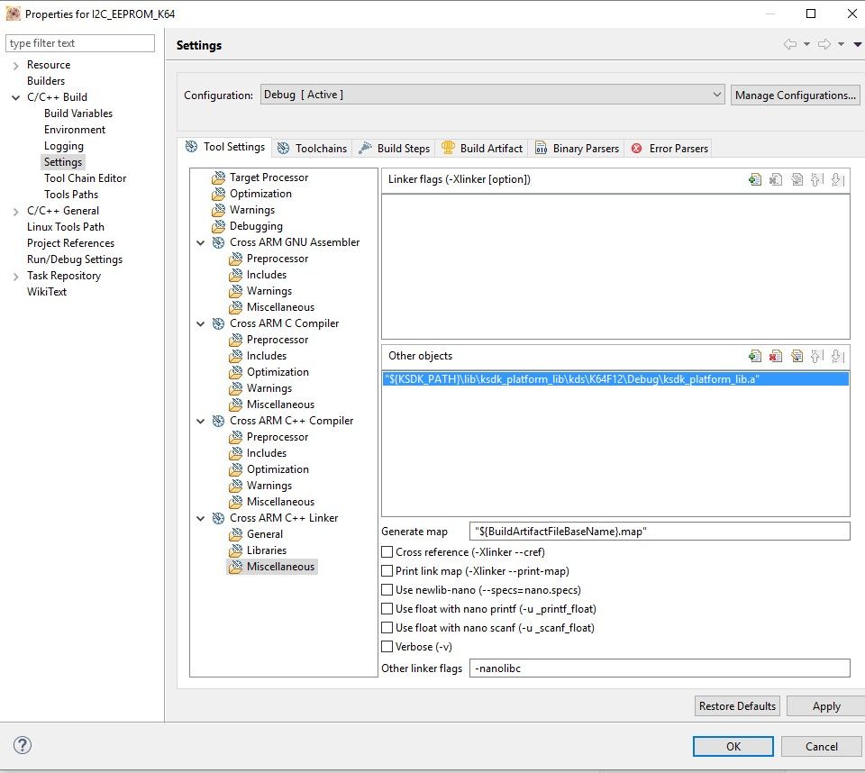

- Do not forget to build the KSDK platform library for your device and add the binary from the linker options (Project -> Properties -> C/C++ Build -> Settings -> Cross ARM C++ Linker -> Miscellaneous -> Other objects).

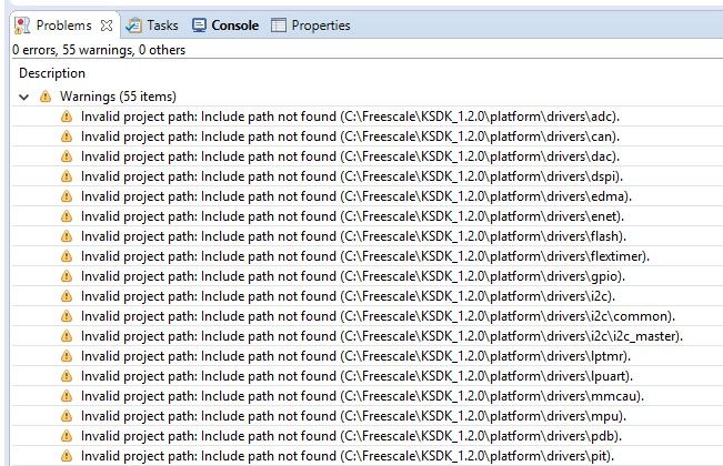

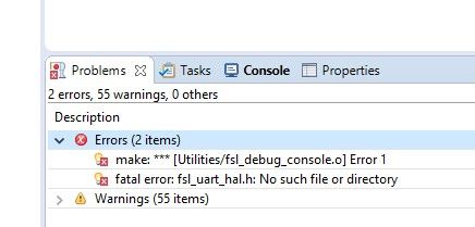

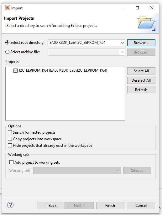

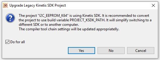

Hello Jorge;
Finally I have time to check your Project Import recommendations.
The final results are importing warnings and Build errors that I don’t understand.
It was done with KSDK 1.2 and 1.3.
I’m attaching images of my Importing steps.
Unexplained import message
Project setting
I don't understand what is wrong in my steps
Shaul
Hello Shaul Dorf:
You tried to import the project and fix it to work with KSDK v1.3. As I mentioned it should be simpler if you create a project for KSDK v1.3 using the project generator and then just copy the relevant EEPROM source/header files from my example.
/Jorge Gonzalez

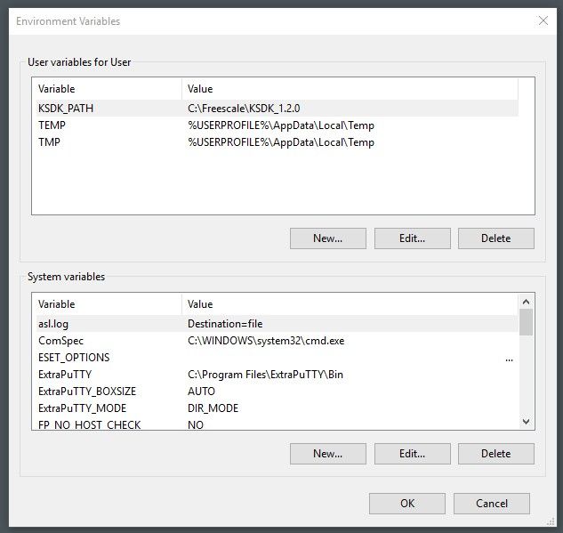

Hello Jorge;
1. My initial assumption was that import is working. Now I understand that it is good for importing examples from KSDK examples folder. Is it correct?
2. I create new project using “Writing my first KSDK Application in KDS Hello World and Toggle LED with GPIO Interrupt”
3. I used your files from Sources folder and hardware_init.c from Board folder.
4. I had changed the HW_I2C2 to 0 in fsl_i2c_irq.c
5. In hardware_init.c there is variable named HW_PORT_INSTANCE_COUNT (lines 68 and 88) that Builder claims as undefined. I didn’t find where it is defined, without any knowledge why I changed it to 10.
6. There is only one warning that variable ‘dataRByte’ is not used file I2C_EEPROM_Example.c (line 60)
Shaul
