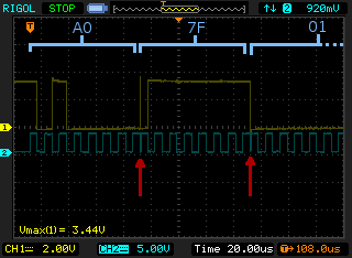

I'm just looking to test out some simple DSPI Master transfers (non-DMA operation) on the FRDM-K64F using the KSDK (1.0.0) Master peripheral driver.
The API seems pretty straight-forward.  However, with in each byte in my transfers, there's a glitch between bit 0 and bit 7 of the following byte:
This only appears to happen for the kDspiClockPhase_FirstEdge clock phase option.
I was just curious if anyone else has run into this. The code's attached.

JonSzymaniak
A colleague of mine kindly pointed out that I have overlooked the DSPI_DRV_MasterSetDelay() API function.  Using this with the kDspiAfterTransfer option) has allowed me to introduce time between successive words within a transfer.
I'll have to take a look at the datasheet and the peripheral driver to understand why I needed to do this for kDspiClockPhase_FirstEdge, but not kDspiClockPhase_SecondEdge....will try to report back here, if anyone is interested.
Just as another minor note -- I see the data is idling high, hence that momentary spike between data byte 0 and data byte 1 in my previous screenshot.

codylundie
I am experiencing the same behavior under the same conditions. Was DSPI_DRV_MasterSetDelay() the ultimate fix, or did you uncover anything else?
