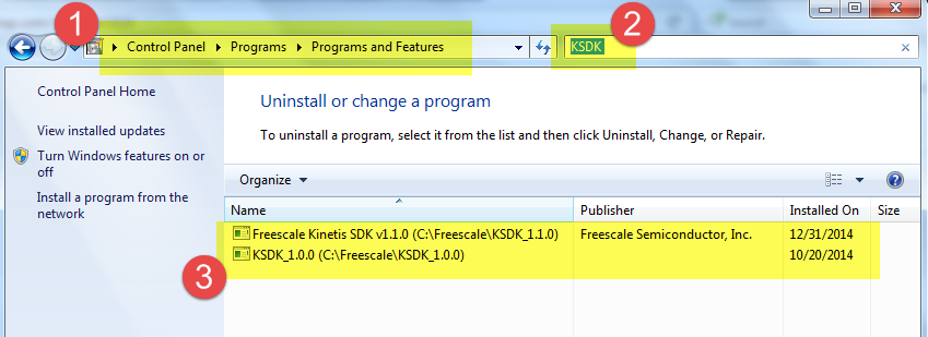

Hi Rande,
For early version KSDK,  wen can uninstall them in windows control panel "Programs","Uninstall a program". search with "KSDK" you will see
As I see, the later version KSDK doesn't appear in this panel, thus you can simple remove the KSDK install folder after you uninstall KDS.

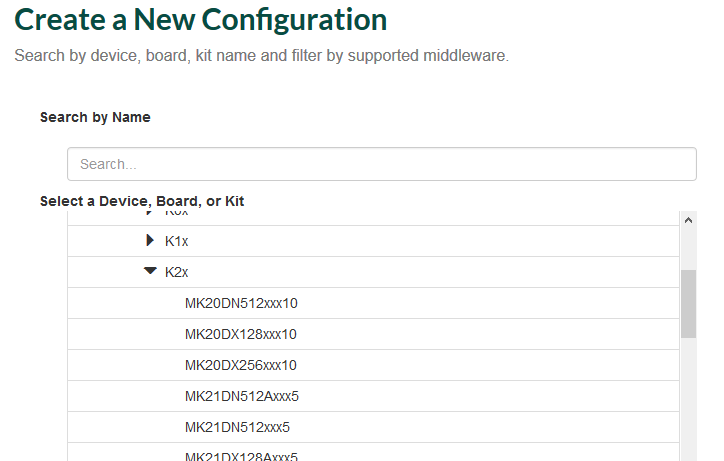

randenewberry
Hi Jennie,
I had KSDK 1.3, and did remove it. However I found that KSDK 2.x does not support my MK20DX64VLH5 processor. It shows in the list of supported devices, but when I select the Processor (K20), there are only 3 selections as shown below:
So I want to download the KSDK 1.3 and install it into KDS 3.2 which I installed this AM.
But I can not find where to download the KSDK 1.3.?? (If I recall it came in a zip file)
Can you direct me to this download please.
Thank you for the assistance!

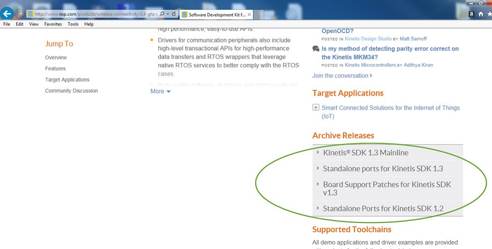

ZhangJennie
Hi Rande,
here is to download old ksdk versions:
Software Development Kit for Kinetis MCUs|NXP
scroll down, it is under"Archive Release"
