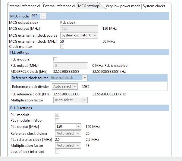

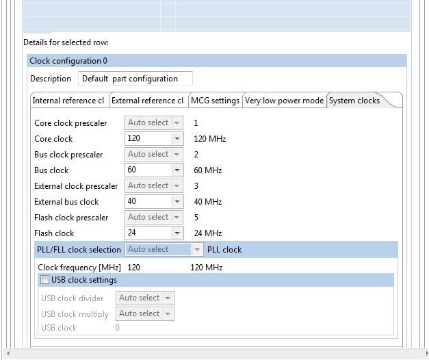

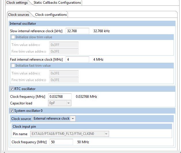

We are trying very hard to do the clock configuration. However after doing the required changes on the clock manager and importing all the generated files to the IAR project. We are still not able to get the required clock working or atleast not able to get any value when we call out
  uint32_t TEMP = 0;
  TEMP = CLOCK_SYS_GetSystemClockFreq();
so should we do any clock Init by calling out CLOCK_SYS_SetConfiguration() actually got to see that CLOCK_SYSupdateconfiguration is never called nor the clock init. Any hints about getting out of this problem The clock configuration was done as shown in snapshots below.

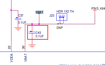

Is VBAT pin powered in your custom hardware? Otherwise the execution will enter a hardfault when trying to access any RTC register.

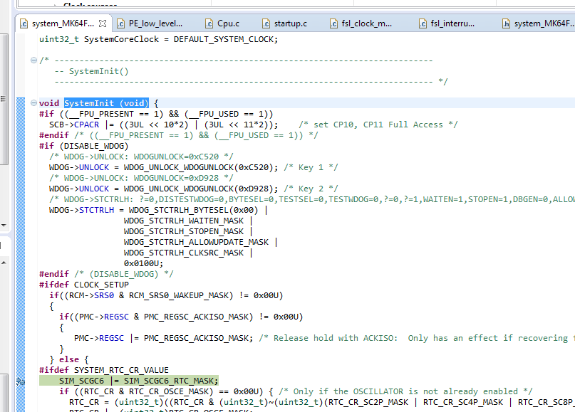

- About the clock of SDK , after configure it on PE,  generate code , the function  SystemInit (void) of code will
configure the clock  refer to the configuration on PE , you can set on breakpoint before download the project , you can see
it run to this function :
And  You can still use those with the clock_manager APIs
(CLOCK_SYS_Init(), CLOCK_SYS_SetConfiguration(), CLOCK_SYS_UpdateConfiguration(), etc) to configure the clock .

I have the RTC osc enabled as you could see and the hardfault error is coming right when it hits the if condition(below in bold)
#ifdef CLOCK_SETUP
  if((RCM->SRS0 & RCM_SRS0_WAKEUP_MASK) != 0x00U)
    if((PMC->REGSC & PMC_REGSC_ACKISO_MASK) != 0x00U)
       PMC->REGSC |= PMC_REGSC_ACKISO_MASK; /* Release hold with ACKISO:  Only has an effect if recovering from VLLSx.*/
  } else {
#ifdef SYSTEM_RTC_CR_VALUE
    SIM_SCGC6 |= SIM_SCGC6_RTC_MASK;
   if ((RTC_CR & RTC_CR_OSCE_MASK) == 0x00U) { /* Only if the OSCILLATOR is not already enabled */
      RTC_CR = (uint32_t)((RTC_CR & (uint32_t)~(uint32_t)(RTC_CR_SC2P_MASK | RTC_CR_SC4P_MASK | RTC_CR_SC8P_MASK | RTC_CR_SC16P_MASK)) | (uint32_t)SYSTEM_RTC_CR_VALUE);
      RTC_CR |= (uint32_t)RTC_CR_OSCE_MASK;
      RTC_CR &= (uint32_t)~(uint32_t)RTC_CR_CLKO_MASK;
#endif
According to me everything is fine on the hardware side. I am able to run the same configuration on the other hardware with almost same configuration.

It was actually the VBAT which was actually not connected to the 3.3V and the RTC register was being accessed.
