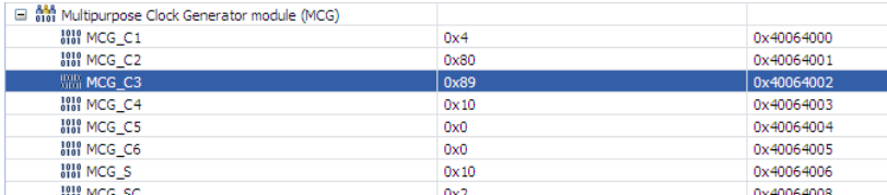

3,in reference,cpu will copy some value in flash to register.
But I create a new project.and i debug it with codewarrior10.3.I find 0x3fe-0x3ff is filled with 0xff.but MCGC3,MCG_C3 and  MCG_C4(bit5:0) is not 0xff.Why?

3> Below code will realize copy trim value to trim register:
if ( *((uint8_t*) 0x03FFU) != 0xFFU) {
    MCG_C3 = *((uint8_t*) 0x03FFU);
    MCG_C4 = (MCG_C4 & 0xFEU) | ((*((uint8_t*) 0x03FEU)) & 0x01U);
4> If Flash was erased with trim value stored Flash sector, the trim value was erased.

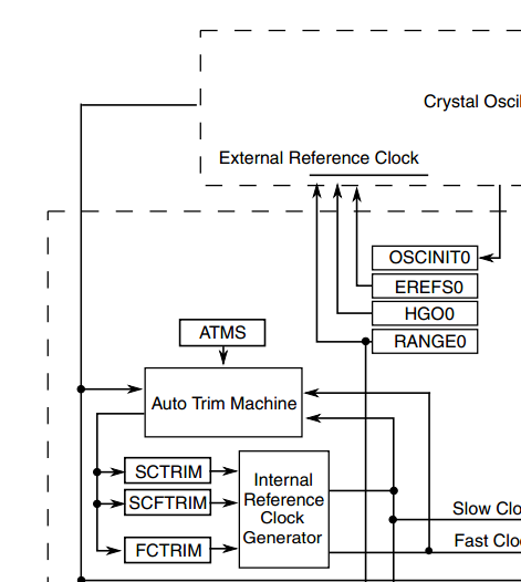

wangbaode
Hi Ma Hui,
Thanks for your answer which resolves most of my questions.But the first question still confuses me.
the screenshot is from reference of kl05z32.
There is a Auto trim machine that can trim internal clock.input clcok of the module is external clock and not bus clock.
So,how can we use bus clock to trim internal clock? is it right that debugger tool use Auto trim machine to trim internal clock?

Hi Baode,
There with description about MCG ATM reference clock source in RM:
The ATM machine uses the bus clock as the external reference clock to perform the IRC auto-trim. Therefore, it is required that the MCG is configured in a clock mode where the reference clock used to generate the system clock is the external reference clock such as
FBE clock mode. The MCG must not be configured in a clock mode where selected IRC ATM clock is used to generate the system clock. The bus clock is also required to be running with in the range of 8–16 MHz.
The bus clock could be external oscillator reference clock directly (FBE or PBE mode).
About how debugger tool to do auto trim, which is debugger tool company property, we have no more info about it.
Customer can use MCG ATM to trim internal clock with bus clock.
