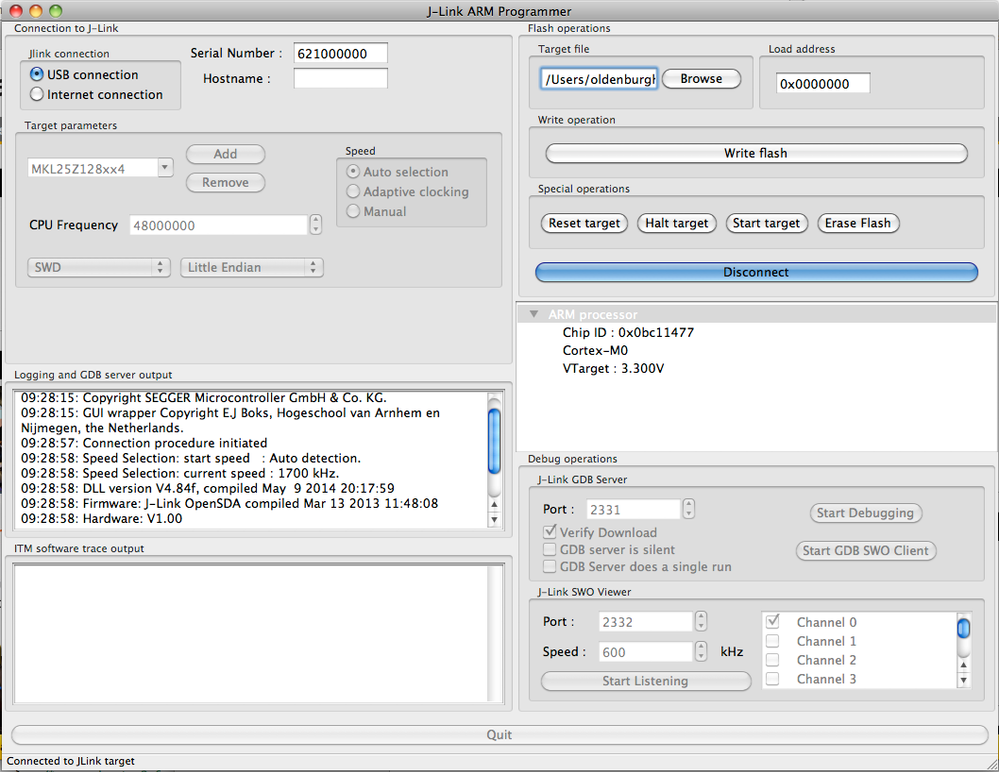

thanks for your introduction to using ARM GDB and GCC compiling and debugging on Linux.
I wrote a GUI wrapper for using the Segger J-Link on OS X and Linux. It does what you describe above, but then using buttons et al. It also keeps track of serial numbers, directories and settings pertaining to the target, so you can use it to store information on a number of targets you're working with. Here's a screenshot of it (on Mac OS X) connected to my FRDM-KL25Z :
My wrapper runs on Windows/Mac OS X and Linux (64 bit). It can be found at this URL : JLink programmer
